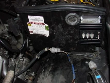

Ok, next I mounted the hellroaring and ground fuse block.
I chose the very outside of the back of the new battery tray to mount the hellroaring (same place as cruiserdrew). The location of the air filter forces this location taking into account cable lengths and ground location. I only used three nuts and bolts to mount the hellroaring because I could not find a position on the tray that had flat spots under all of the hellroaring mounting holes (the battery tray has many corrugations that makes it difficult to find a good flat spot.) It is still very secure with three bolts.

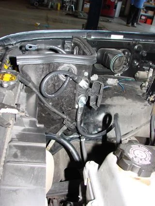

I mounted the 150A bussman ground fuse block to the other back side of the new battery tray.
I made sure I used washers behind the battery tray for the hellroaring and ground fuse mounts as it is fiberglass-embedded plastic.
Picture 1 is the mounted hellroaring (note the relocated unknown wire harness)
Picture 2 is the mounted bussman fuse
