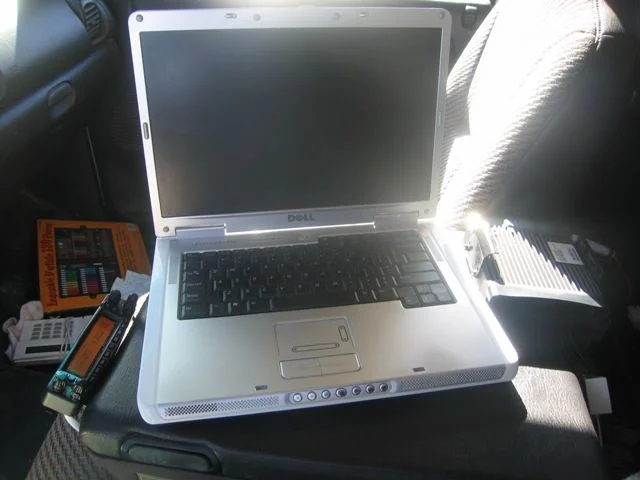

Here's a pic of my setup as I am reprogramming it in my Dodge. I can easily move the radio between my FJ40, truck, and suburban.
Name:  8900 programming setup.jpg
