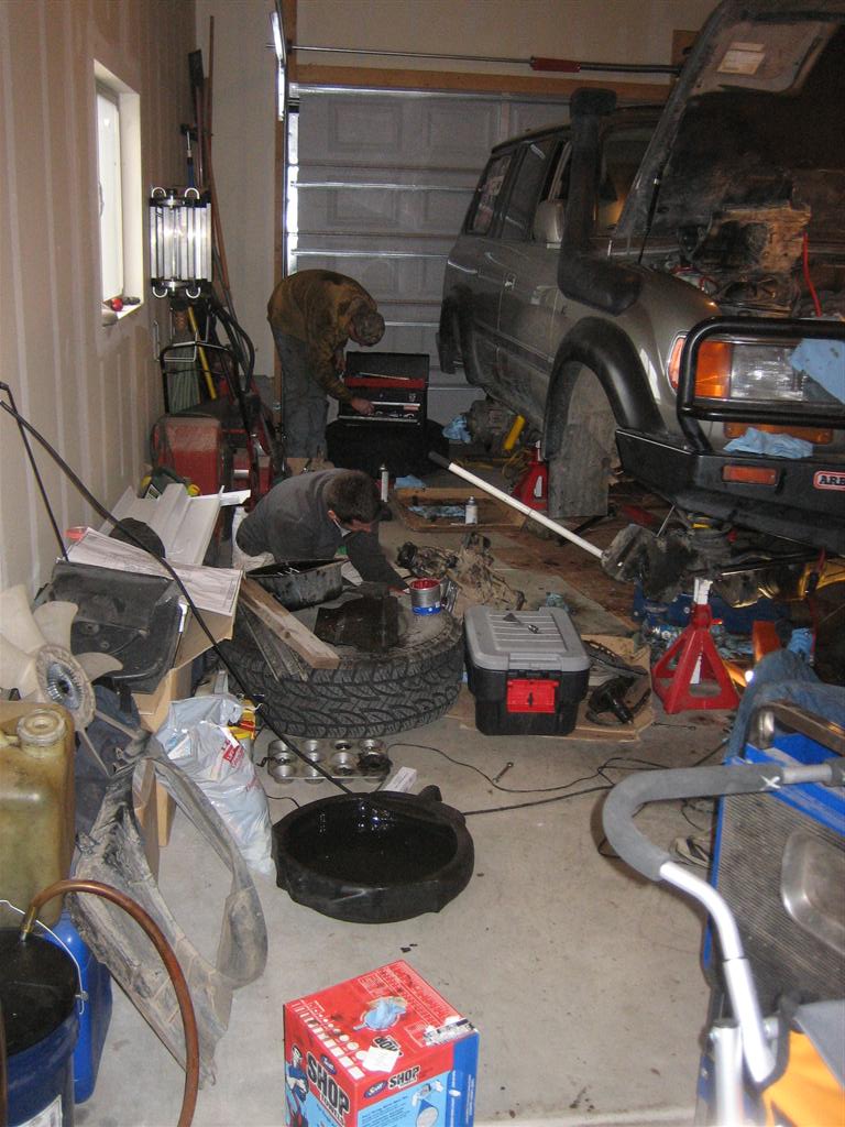

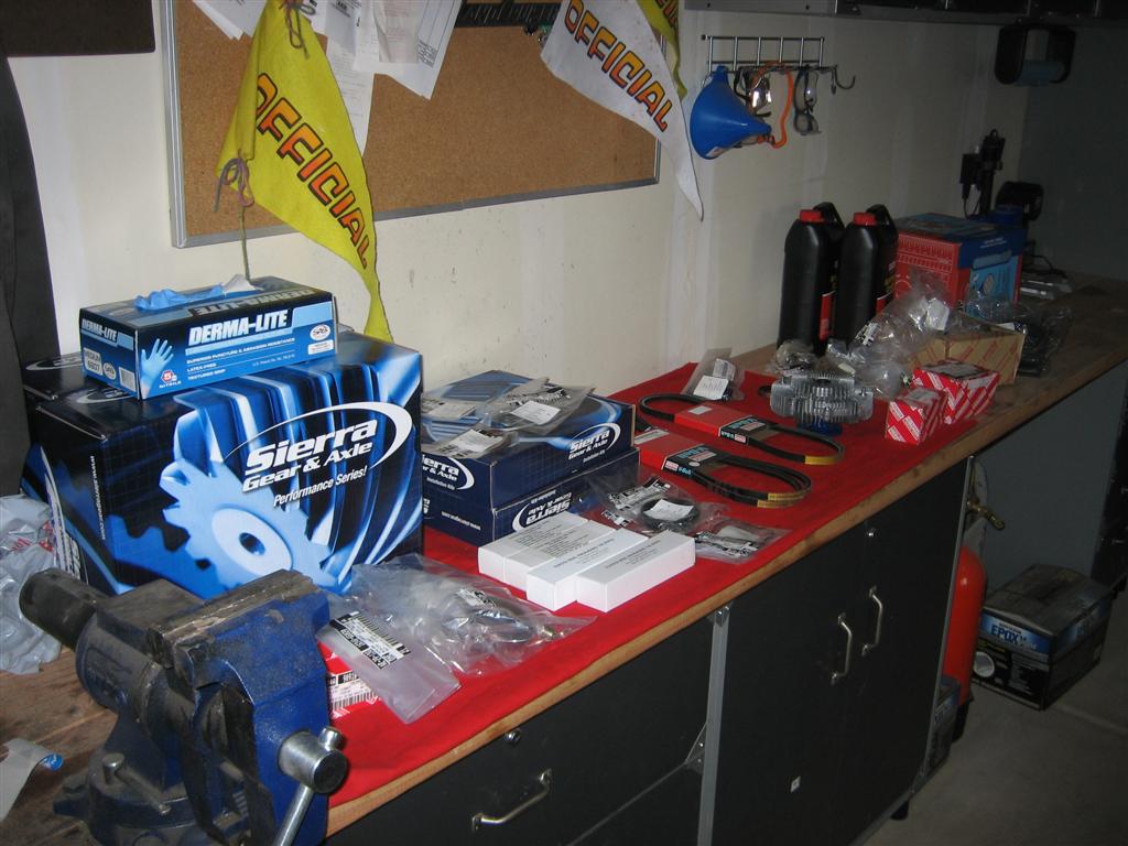

The debate on gears has been on going for a few years. As with a lot of 80 owners the cost of gears is a hard pill to swallow. however it was necessary for me with all the weight and some of the elevations I would see. Even then the debate was between 4.56s and 4.88s. After a long talk with Kurt (all talks with kurt are long) at Cruiser Outfitters I went with the 4.88s. figured if I didn't like them once i got home they would have better resell value than 4.56s. i have a great set of friends who helped me complete the project over a weekend. it wasn't just gears however, it was also tcase seals, oil pan and timing cover leaks and the blue hub fan clutch. it was truly amazing how much work 5 guys can accomplish on a cold October weekend.
