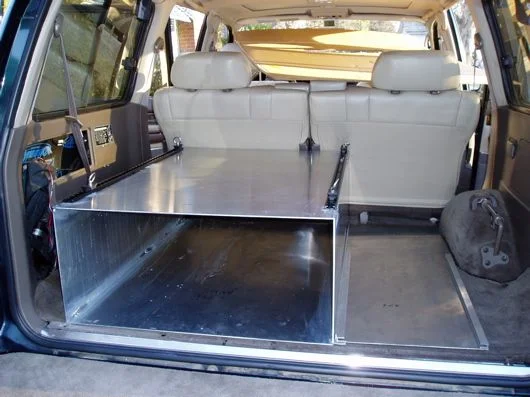

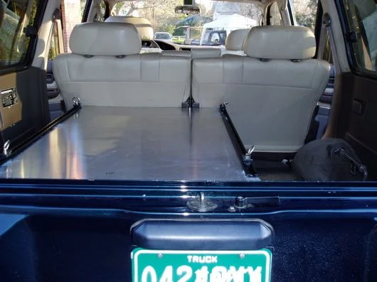

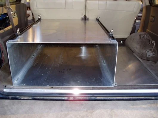

I finally got some time to start on this project , I prolly should be doing something more important but hey......
I was going to wait until I was complete to post up but I have no will power
The material is 1/8 5052 initially I was trying to do honeycomb , but there were no good deals on material to be found.
What you see is the shell of the main storage compartment , on the right will be a custom fridge slide . On the perimeter of the main system will have hinged "wings" for a flat surface all the way to the aft of the front seats.
More to come ( as soon as there is time)
