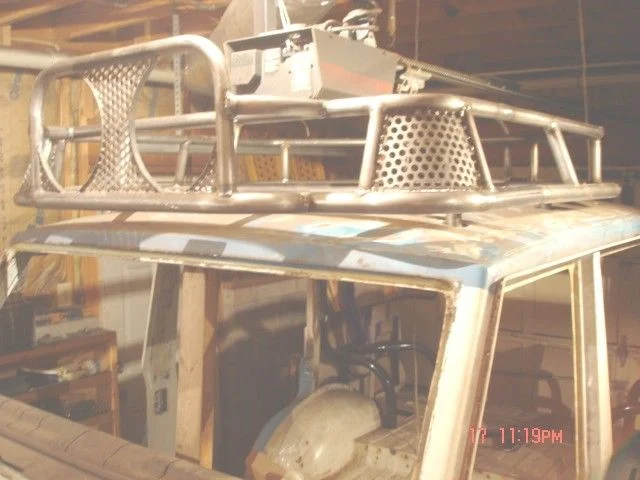

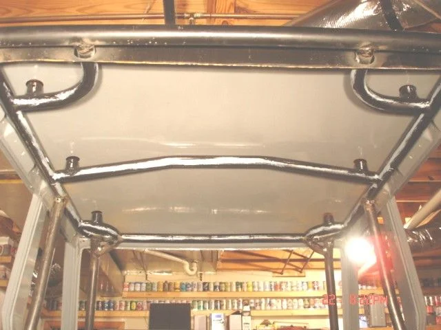

I made mine from 1 1/2" & 1 1/4" tube & mounted it thru the roof. I'll add some false bases made from sheet metal & large rubber grommets to seal the roof later on in the build
