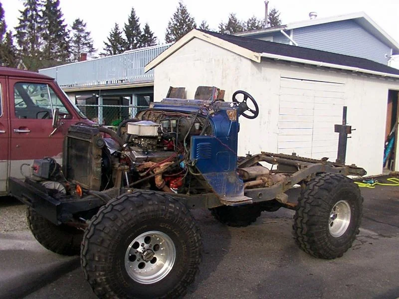

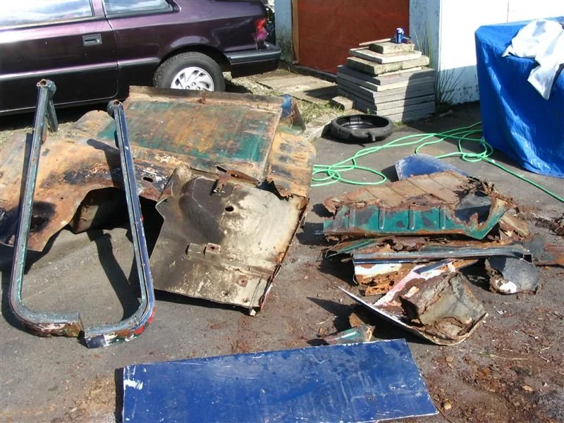

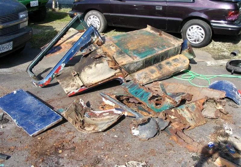

ripped it all apart when it was blue
put it back together and painted it burgundy
here is the rebuild .put it all back together .1978 .chassis and V.I.N.,1975 body ,67 bib,75 hood ,78 fenders (new oem),
73 split tail gate, front and rear lunchbox lockers ,4.11, 350 chev mated to sm465 ,to 3spd t-case,4 wheel disc brakes.
saginaw steering.SOA,C&T ,3 inch bodylift,warn 8274 ,ultimate air co2, 38.5x14.5 tls sx swampers ,flipped front springs ,
with spring perch drilled to move it back a inch or so ,rear stock with spring perch drilled to move axle back a inch or so
.up next on the to do list is to purchase a metaltech jackson cage put in the rear jump seats ,put in the chromo birfs,
order luke's high steer . put on the aisin hubs and have my oem steelies widened.Oh ya sorry for the checker plate.
a little bit to much beer and the little lady talking me into putting it back on.
