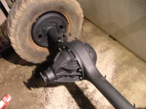

The shackles front and rear were pretty rough so I ordered a set of 1.5" lift shackles from Ebay. (bad idea in retrospect. They hang WAY low in the front.) I pulled the axles front and rear, wire wheeled them to death, and gave them a fresh coat of paint. I sprayed them gloss black first with a coat of flat over top. I like flat black better but wanted the better rust protection of gloss. Should've not been so cheap and just gotten POR-15.

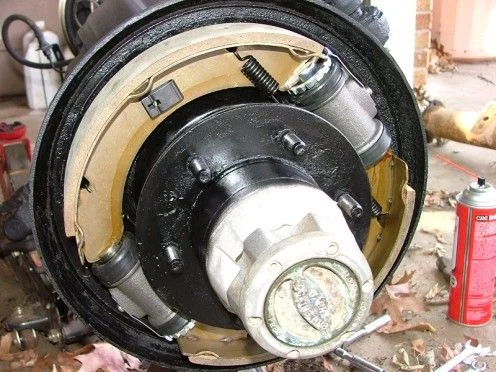

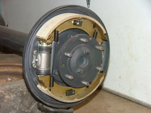

The drums were hard to remove but I finally got them off. New wheel cylinders, shoes, springs, freshly turned drums.... it went together alot easier than coming apart.
