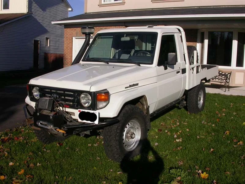

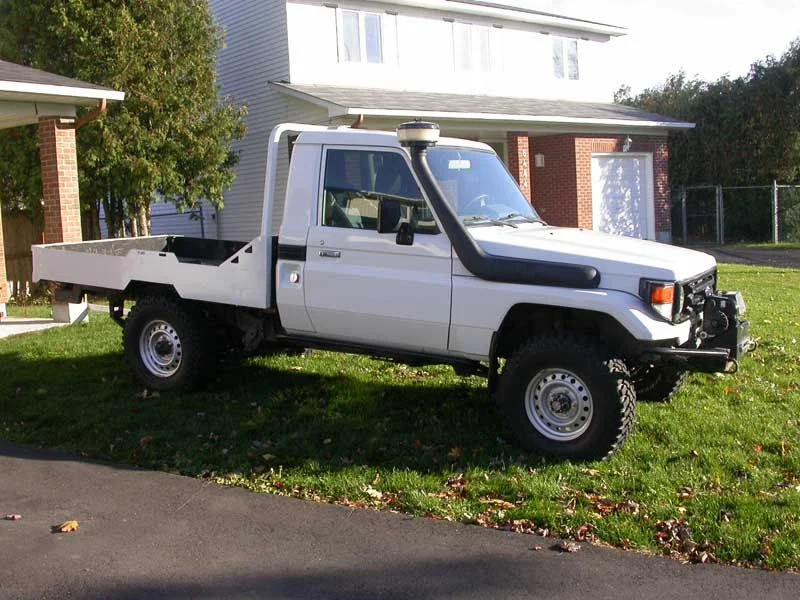

Did you end up buying a front clip from G and S? Once the body panels are replaced it will look awsome. Dedicate a full day to dissassemble the interior - go right to the firewall as there is alot of dust in there to clean out. I even dissassembled the air blower box and cleaned it out.
Dedicate another day to cleaning interior parts, I had a big plastic rubbernmaid container that I filled with hot water . I would just soak and scrub with a scrub brush and spay fantastic on the parts and pieces - everything come up to pretty much new condition - I even did the inside of the vent tubes.
The headliners are nasty - but buy that acrpet cleaner fluid you can get at home depot or sears - whatever - and soak and scrub - the headliner comes out like new as well.
Once my rocker panel was in I used POR15 on the whole inside of the cab, and - strip the carpet off the floormat as it is soaked with dust and shit and won't get rid of water when you wet it. I used FATMAT sound deadener material on th ewhole insde of the cab - from top to bottom - and I used an under hood deader on the insde of the roof as well to make the inside very quiet - I would think about doing that as well. I also popped the panels off the doors and did them with sound deadener. That takes a few hours.
Thats it for now!
