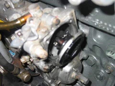

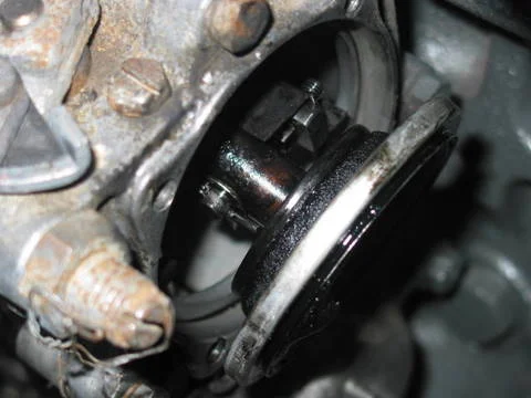

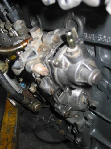

Thought I would post some pics of this. I did one earlier this summer and had some issues finding info on removal. Specifically, the nut that holds it to the shaft is an 8mm.
Pics might be useful to someone.
This engine is hanging on a hoist and the edic motor and mount is removed for better access.
1. Where to find the diaphragm
2. With the cover removed
3. Close up so you can see where the nut goes - you can see the threads on the right side of the shaft inside the housing.
