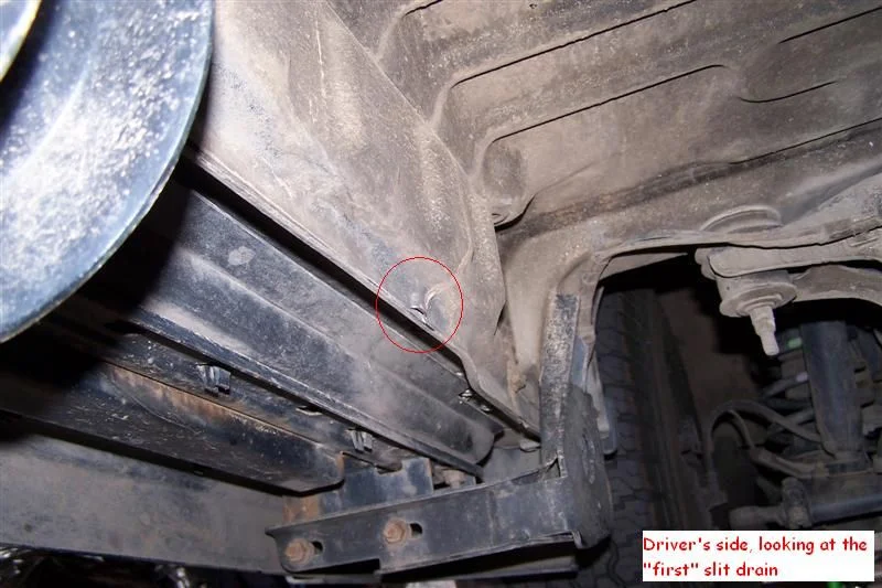

there are also the drains in the pinch weld that you should keep unclogged. You can search drains, leaks, norcalsam, norcaldoug and prob hit some pics and descriptions
x2 on the drain slits - Also, as others have mentioned there are 4 drains for the sunroof (at least on later model Cruisers), 2 front and 2 rear. The rears are tough to see as they are way back there.
Since this is the FAQ I'll add some pics of the slit drains I posted awhile ago in this thread: http://forum.ih8mud.com/80-series-tech/152124-sloshing-sound.html
