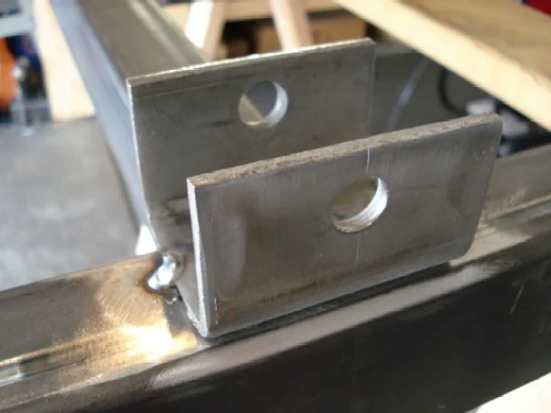

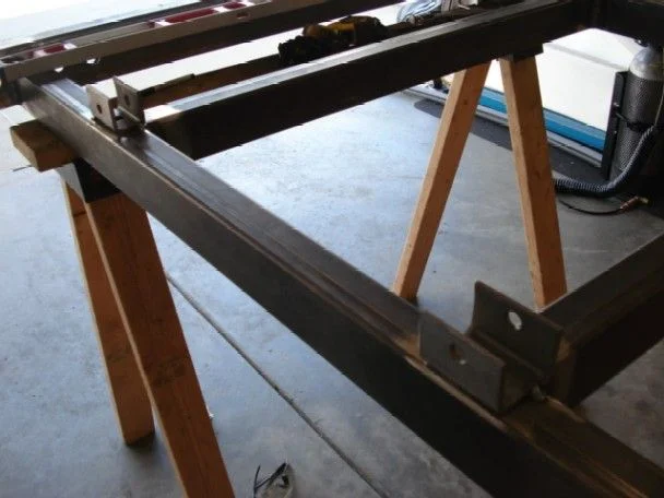

Got the chassis "rolling" today. It was a fun day of measuring and tacking some of the major suspension components into place.
I started out by lugging the chassis back to the saw-horses for about the 100th time Then I measured out each of the spring hangers and tacked them into place.
I am not sure where but I was off about an 1/8" toward the rear on the drivers side, once I measured for square everything checked out, but it has me puzzled, the axle is square to the drawarm, I just can't find where I am missing the 1/8"?
Anyhow, after measuring for another hour, I realized as long as the axle is square to the draw-arm, I was fine.
