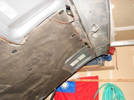

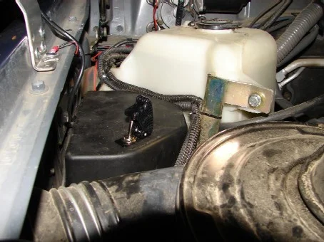

These same 1 watt bulbs were used as engine compartment lights. I used two this time and RTV’d these to the underside of the hood. With the hood open, they shine directly into the engine compartment. They work great, because the natural light doesn’t screw up the colors in the engine compartment. A toggle switch in the engine compartment turns them on and off. I worried that heat and water might affect the LEDs. So far, so good, but the jury is still out as far as durability. As far seeing the engine, they’re awesome!
These pictures show the switch that I installed on the cruise control cover, and the LEDs installed on the hood. The lights are very bright, but only draw a combined .260 amps. Or a little more than a single stock 194 bulb, but much brighter and whiter. Having two of them covers the entire engine comparement very well, as opposed to a single center light. These lights could literally be left on for days at a time, without making the battery flinch.
