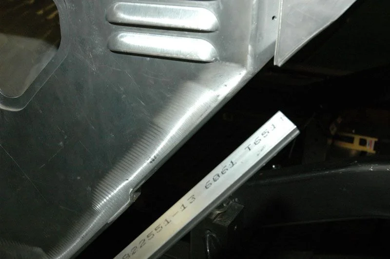

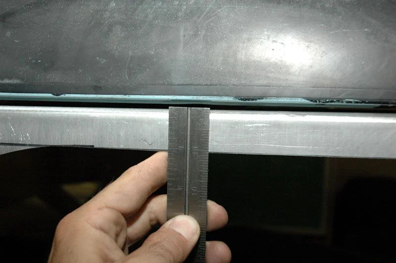

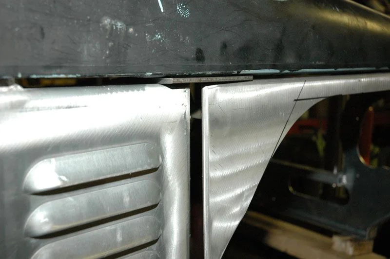

I need to add 1/2" of material between cowl and apron to get the hood to flush out on the grill...I will be welding bar stock in there and you wont even see it after its welded and buffed down. Apron allso reduced to 1" to hoodline.
The 3/8" spacing on the cowl to fender will also be filled for the 'smooth' look. I really dont like the gap so it will be made flush with the fender.
