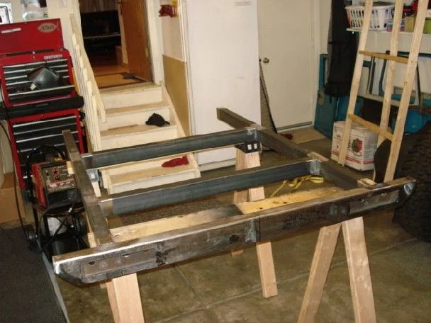

Once tacked in place and totally squared up, I was able to move it off the floor and onto a set of sawhorses which made it much easier on my back!

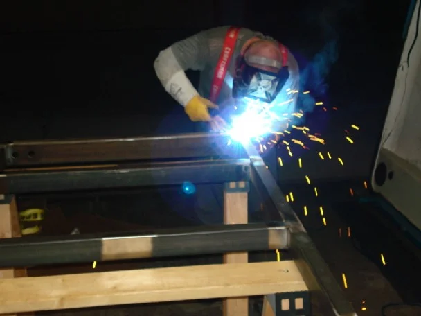

Then I welded all the top and bottom seams moving from the rear to the front. I made sure to move the welds around from side to side as we went forward as not to warp the frame through too much heat.
...then we called it a night.
