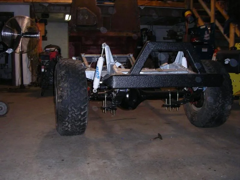

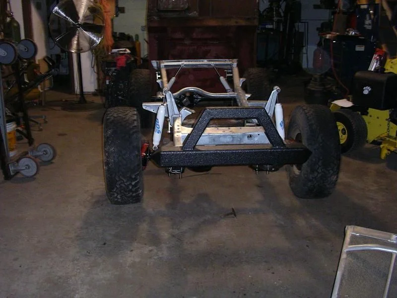

Finaly got a rolling chassis built. I am about a week~ish behind where I want to be, but what ever I am having fun and the girlfriend (its her truck) is happy.
Quick specs:
2.5in BDS
Galvinized frame
mini truck nuckels 27stock birfs
Vented rotors, IFS mini calipers
9.5 in wide rims, Big flat Centerline's
Vortex'ed midevil looking bumper.
I am starting the steering mockup/build once I get the tub floor welded and set on the frame.
thats the tub behind it, standing on the tailgate section The tins and Tub will go to Garnett blasting hopefuly next week, while they are gone Ill swap in motor/trany/tcase. Fmotor/4sp/3spd case
