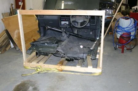

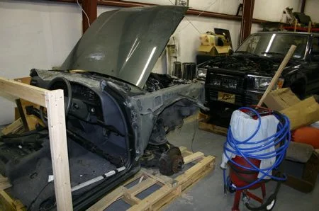

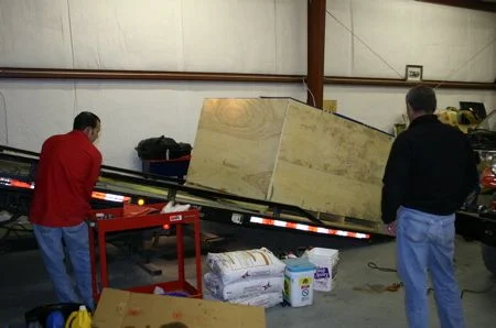

The engine I bought was actually in the form of a half-cut. If you haven't seen a half-cut, they take a vehicle, and simply cut it off just behind the transfer care. The rest of it comes to you in a big box. The reason I went with a half-cut was because it includes not onlly an engine, but EVERYTHING else required to make it work. Also, it gave me the ability to look at what it was supposed to look like, and not try to cobble it up from a pilt of parts.
Some quick diesel engine stuff for you: the L series diesels and the R series gas engines are interchangeable. The motor mounts, the transmission mounts, etc... You can bolt in an L series engine in place of an R. The bellhousing is different (because the starter is on the passenger side for the diesels), but other than that, it's that simple.
First there was the L, which got a little more displacement to become the 2L. When the 2L got a turbo it became the 2L-T. When the engine got some internal improvements, it became the 2LII-T (which makes a lot of parts not interchangeable, but still the same basic block). When the 2LII-T got an EFI setup, it became the 2LT-E. There is also a 3L engine (which has more displacement, but is normally aspirated--but it shared most everything with a 2LII series). I got a 2LT-E.
So, I ordered a half-cut from JARCO, from an LN-130 Surf. The LN-130 is basically a 4 runner.
Here are some pics of the half cut being unloaded, and then 2 pics right as it came out of the box.
