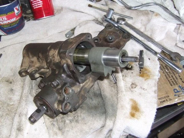

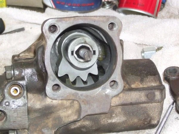

After taking the top plate off you can slide the sector shaft out by pushing from the pittman end up. The sector shaft actually slides towards where the top plate is. Be careful of the orientation of the teeth on the sector shaft. There are certian positins where the teeth can bind during dissassembly..
