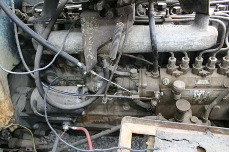

Well, looking under the cab, there is definitely not a vacuum tank of any kind. I also don't see any mounts for anything else under there (looking like it had been removed).

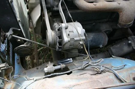

But here's some pics of the throttle linkage and general right side of the engine, and also of the alternator. The alternator is a Denso part, but who knows if it's an original for this truck.
You are right about the radiator. I don't know if it's the original (but it is a Toyota part), but it's only mounted with one bolt right now. There are two bolts on the bottom of the radiator, and two mounting tabs on the front crossmember, yet only one lines up (and therefor only one is secured). So I imagine that the radiator is not correct for that truck.
