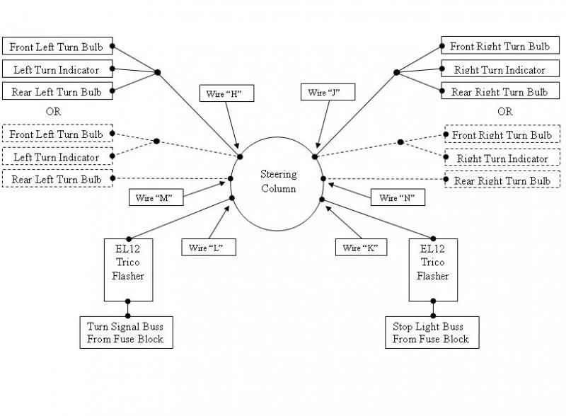

The second picture shows the connector used for the turn signals, hazards, horn, etc. Again I'll list what's connected to what.
Letter:
E. Connected to "F" when the ignition key is in Run, Acc, Start
F. See "E"
G. Horn, connected to ground when horn button is pressed
H. Left Front Turn Signal, connected to the Turn Flasher input, "L",
when the turn signal stalk is pulled down, or connected to the
Hazard Flasher "K" when the flasher button is pulled
J. Right Front Turn Signal, connected to the Turn Flasher input, "L",
when the turn signal stalk is pushed up, or connected to the
K. Hazard Flasher input
L. Turn Flasher input
M. Left Rear Turn Signal. See "H" above
N. Right Rear Turn Signal. See "J" above
P. Stop Lamp Switch (not used on the Cherokee)
My Turn Signal & Hazard Light solution deletes the stock Hazard switch and and stock flasher unit. I don't like the stock flasher location, and I'm not sure if my big hands could even reach it if I ever needed to replace it. This solution uses two very standard Trico flashers that can handle 1 to 10 lamps each. This way if the turn signal flasher goes bad, you can substitute the hazard flasher in until a new one can be purchased at most any autopart joint for way less than $10. The Turn Signals will get their power from the stock Turn Signal buss found on the fuse block, and the Hazard Lights will get there power from the Stop Light buss on the fuse block. This will allow the Hazard Lights to work at all times, and the Turn Signals will only function when the key is on.
1. Remove stock Hazard Switch (unplug)
2. Hook up 2 Trico EL12 flashers as shown below
3. Connect Contact “H” up to the Left Turn Signal wire in the FJ40 Harness
(For my ’77 this is the Green with a Black stripe wire)
4. Connect Contact “J” up to the Right Turn Signal wire in the FJ40 Harness
(For my ’77 this is the Green with a Yellow stripe wire)
The stock wiring (GB & GY wires) are already connected to the front and rear turn signal lights, along with the indicator lights. So the “M” and “N” contacts on the new column are not needed.
I'll stop for now, and will be adding in the future how I'm going to wire the headlight dimmer connections as well. Please provide any and all feedback.
Jeff
