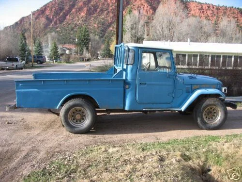

Here's a pic of it with the bed, this pic was on eBay. I've got to resize my other pics, I should be able to resize those later today.
