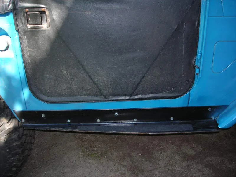

One of the "budget" mods I did some years ago was an idea I "borrowed" from my friend Kevin. He found a weird piece of five inch by three inch by 1/4 inch steel angle iron, and used it to fab-up some heavy-duty side steps. I used a piece of four inch by four inch by 1/4 inch steel angle iron to make some side steps; see this photo for a better idea.
