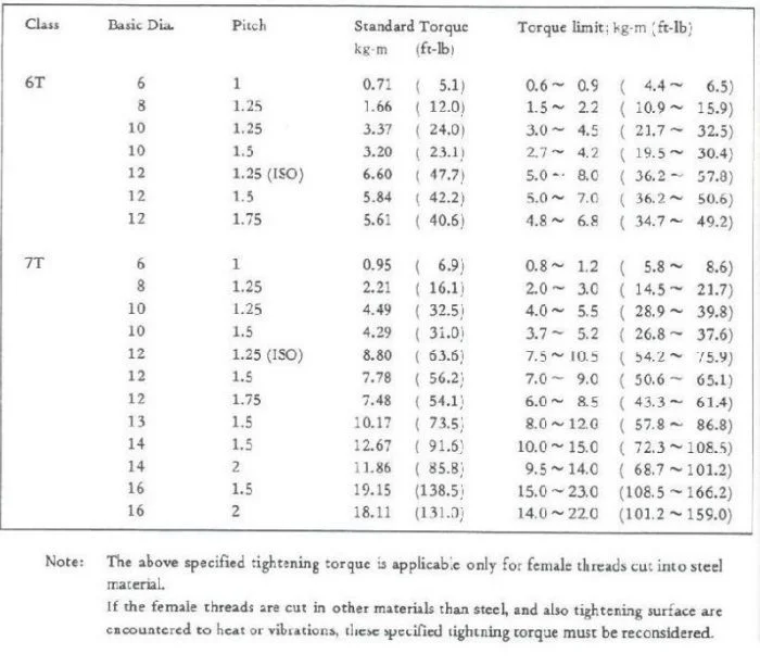

"Generic" Torque Specs From the FSM
Here are the Generic Torque Specs from the Back of the F Engine FSM. Scan was easier then retypeing this as they were all in one place - I hope Toyota won't be pissed!
Name:  Torque Specs 1.JPG
Name:  Torque Specs 2.JPG
