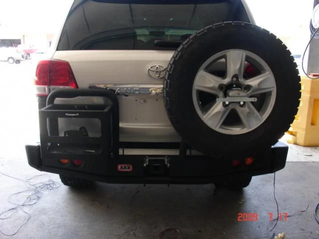

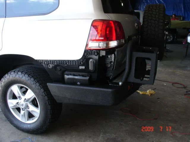

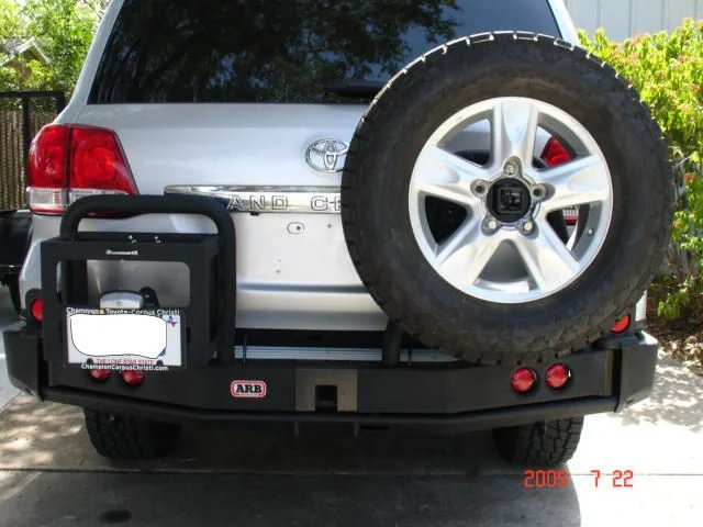

Here are some pics showing carriers. The bumper came with a license plate bracket for the tire carrier but I decided to have it moved to the jerry can holder. This way I would not have to remove the license plate to gain access to the tire. Needless to say, the installation has been a challenge - 3 different installation manuals!
Don, do you have PDFs of these manuals? According to ARB there is only one...what are the 3 versions?? Thanks

I don't have pdf but there are 3 - bumper, jerry can, tire carrier. Install will run into tomorrow and maybe Monday as they try to determine if they can save sensors.

First, thanks for the complements. It has been receiving a good number of double-takes. As for words of wisdom, I can only offer observations since someone else is doing the hard stuff. Read, read, and re-read all instructions and familiarize yourself with parts. Prepare yourself for a long install. Mine's been in the shop for nearly a week, mainly due to their meticulousness and the fact this is their first ARB tire carrier install. I'm sure shops with more ARB experience will install in 2 days or less. Expect some . They chipped one tail light installing the jerry can holder but had one on oder by the time I dropped on by for pics. Lastly, enjoy the process. Its been fun watching the process take shape.
Frankly, I'm amazed at all the pieces this thing requires. JB, I admire your ability to take on such a project.
One suggestion I would make to ARB is to produce a complete side panel. Makes no sense to me to have to trash an entire OEM bumper just to creat a side panel.
Will post updated pics tomorrow.

Another hick-up today. We've spent two days of trying to get running and turn lights to work. A call to ARB informed us of a solution. First, an explanation. The rear bar comes with running (amber) and brake (red) lights and a wire harness to acommodate. A later call revealed it "may" not be needed, depending upon model. After noticing brake lights also act as turn signal and the running lights also act as brakes we called ARB. This is when we found out wiring harness is for European models. Solution now is the replace amber lense with red. Confussing, for me yes.
The installers are trying to separate the signal so we can keep amber light. I like the look and am willing to accept funky turn signal and keep amber running light. Also, bumper has been cut and installed. Looking much cleaner now. Will post pic when trim is installed.
I don't think this will be possible as there is a computer that controls the relays for the lights. The tail lamp is the same bulb for both turn signal (flashing high), rear lights (constant low) or brake (constant high). I beleive it is controled by the voltage to the LEDs.
The only way for the ambers to work correctly is to T-tap them from the engine bay where the fog lights from the ARB bumper connect. Here, there is a dedicated turn signal +12 for each side. They could run a wire all the way from the engine bay, down the frame rail, and back up into the bumper on each side.
As far as I see it, this may be the only way. It's not as difficult as may sound.

I'm thinking along those lines but wont bother the shop with it, I can run the wire. Truck should be ready by noon tomorrow so I decided to take pics when finished.

the IPOR installed ARB rear bumper is in progress.
talking to ARB about the wiring, they said to tap into the wires running into the "towing module" in the left rear panel. the connector that is supplied does not work, so it has to be spliced in.
the bumper is being installed without the swingouts, because we ordered the LHS tire, and RHS jerry(we do it for all ARB rear bumper installs for visibility reasons) and they are backordered.
the sensors have not been decided on, but we will figure something out.
compared to the 80 and 100 series rear bumpers, although similar, the 200 bumper is quite different in its installation(more difficult).
i will try to post some pics when possible, but again it won't have the swing outs installed, just the blanks.

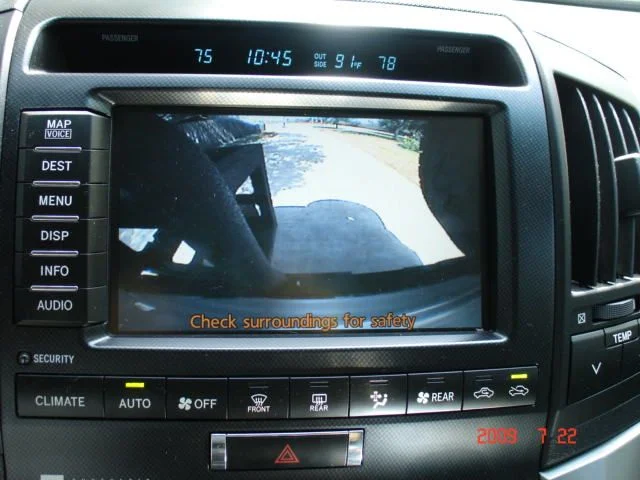

With the LHS tire, you will definitely block the camera, though. Correct? Any plans to relocate it?

If you get them working, please let me know. They've tried here but could not get the signal to separate. And, if you find a way to adequately brace OEM bumper on passenger side, post solution. On mine it is very flimsy, like billow in the wind flimsy. I'll try to post pic of it in the morning.

thoughts on the camera are up in the air.
one concern is that even with the jerry can on the LHS the camera wouldn't really show much.
donjuan, will you take a pic of what your rear camera shows you with the bumper installed? i am curious as to how obstructed it is with the jerry can on the LHS.
will take the "flimsy" prob into consideration.
where did they try to mount the sensors? any info would be great

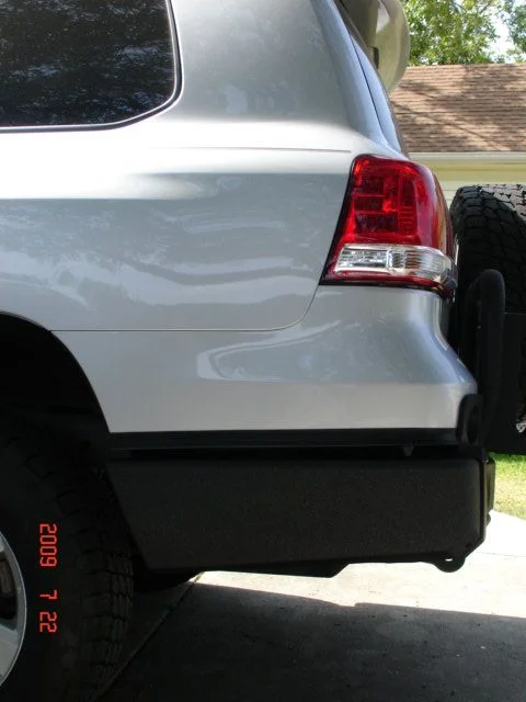

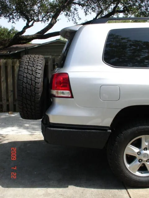

Picked up truck today, looks alot better after final adjustments and reenforced side panel. Gap between side panel and bumper looks tighter, very happy with it. Will post detailed evaluation in a couple of days but I must say I'm glad I installed the OME 440 springs in rear.
Here are some pics of sides and backup camera. At work and don't have way to erase license plate so I'll post rear photo tonight. All comments are welcomed.

Looks good. I thought the camera would be blocked more, but without the cans in there, you can still see pretty well.
Any word on the sensors? What happens when you put the truck in reverse? Do you have the switch on or off?
Any comment on the departure angle? From the pics it looks to be worse than stock. The rear picture will help to give reference to the hitch.

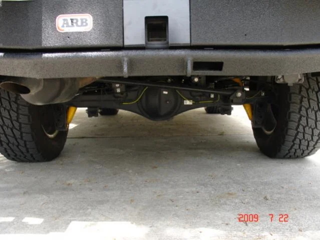

Here are a couple more shots. I need to take a measurement from ground to bumper but I do think departure angle is equal or a tad worse than stock.
