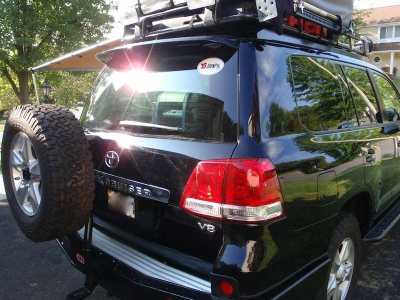

Update #6

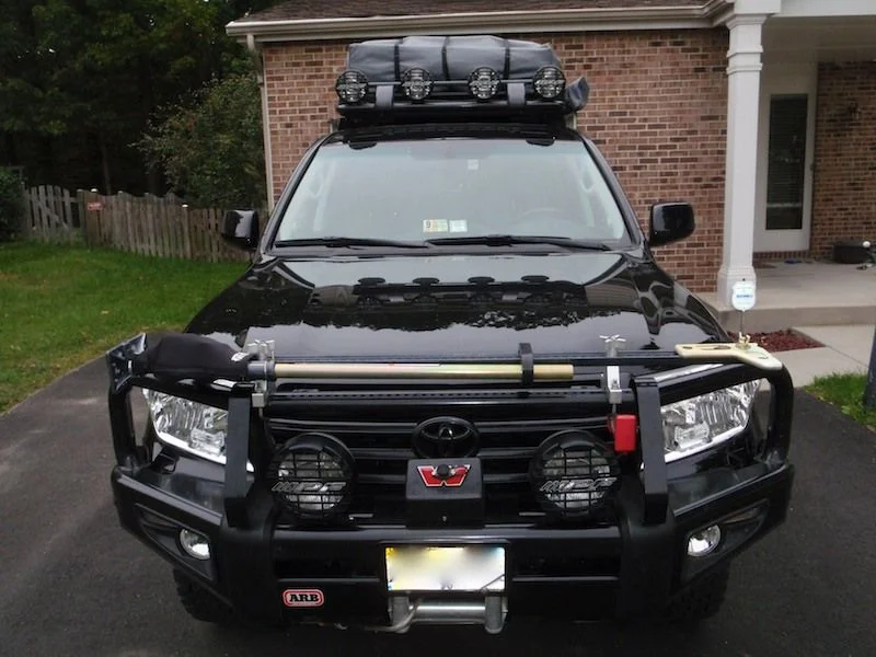

This is what we have so far:
ARB 49” awning
Hi-Lift Jack mount
ARB rear bumper swing gate for spare tire (still waiting on jerry can swing gate)
(2) Adventure Trailers drawers 20" wide, 8.75" high and 36" deep - "36-A" (AT sent (1) 12” high)
ARB fridge slide and tie down straps
Prestigious Society GPS Override
Compressor extension
Expedition one gas and water cans
And our little camping contribution to the hotrod a tire table (or for you hunters out there a tree stand) for Coleman stove
sbly

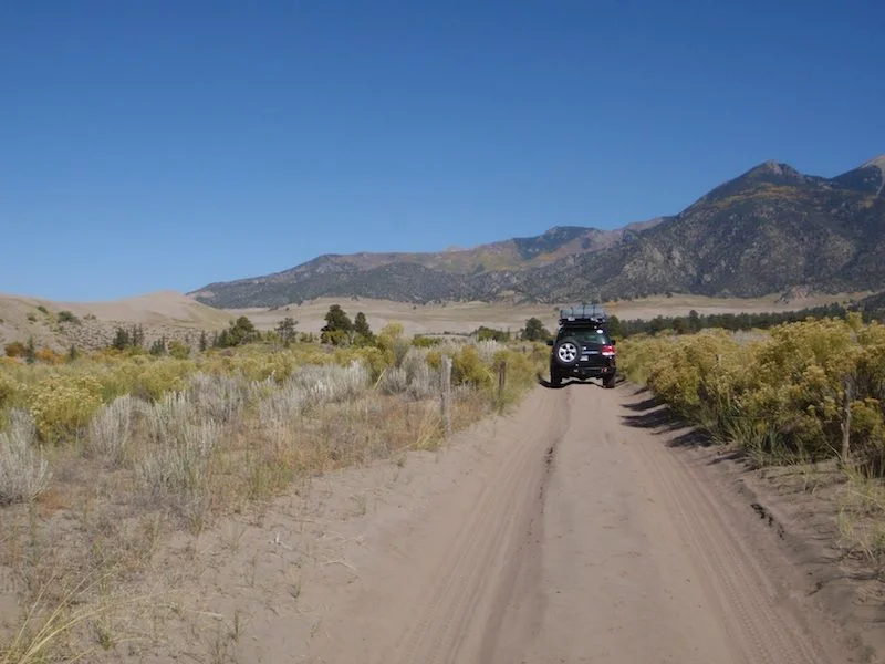

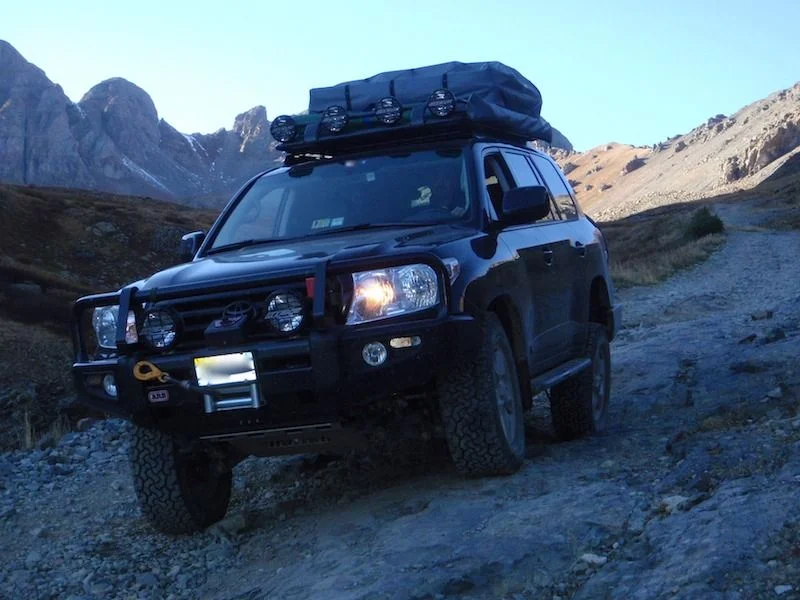

Just an update on the performance of my 200. The wife and I have spent our first 3 days getting from Virginia to Colorado, and the last 4 days driving some easy and moderate trails in Colorado. We built this truck to be a "Overland/exploring" vehicle not a hard core off-road truck.
Here are a few notes from our first few days;
ARB Tent - Did well in 30 MPH winds at the Great Sand Dunes and in 19 degrees temperatures (with snow) at Corkscrew Gulch.
ARB Awning - Easy to set up and a nice place to be when it started to rain.
IPF Lights - I may look into some type of HID upgraded.
Nav Override - Performed as advertised.
Slee Sliders - No real dings so far but have been a great help in dealing with the tent.
ARB Fridge - Worked great right until we accidentally knocked the plug out, but on the good side it was easy to clean all the rotten food out of it.
Additional Rear Outlet - Came in handy for the Coleman hot water heater.
AT Drawers - No problems, but I will be looking into replacing the plastic lock/pull handle with metal ones.

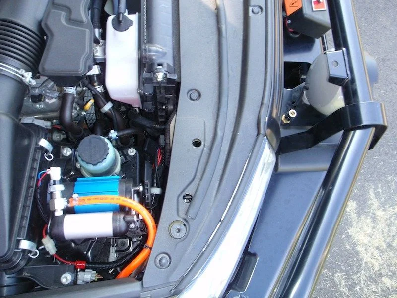

ARB Compressor - Really like the extension in the front grill.
BFG Tires - Worked well, no problems in the snow, water, sand and dirt (easy and moderate trails). I am still trying to find the right tire pressure for both off-road and on-road with all the extra weight.
Suspension - Worked like a champ, no problems.
Expedition One Gerri cans (1-water / 1-gas) - No problems, I just need to find a better way to carry them. They ride great in the ARB rack under the tent, but just a pain to get them tied down.
Front Runner Water Can - Works great, just the on/off valve if still a little stiff.

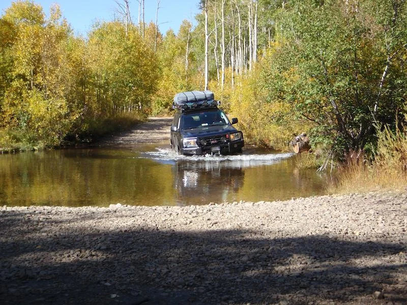

1st Pic - Stream crossing at Great Sand Dunes
2nd Pic - The wife's cooking set-up at Red Mountain (I think)
3rd Pic - Heading up Corkscrew Gulch
sbly

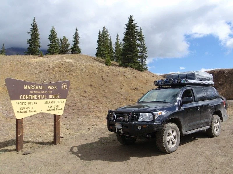

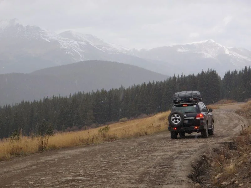

3 More pictures from the trip.
sbly is offline   Reply With Quote

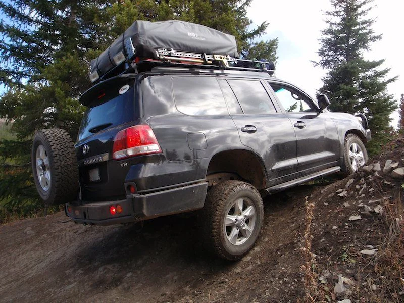

From the last 2 days.
Old 10-04-09, 07:54 PM   #102 (permalink)
Forum Regular
sbly's Avatar
Join Date: Mar 2009
Location: NOVA
TLCA# 19511
Posts: 80

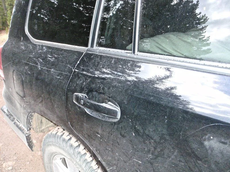

The first 1 is some of mother nature's pin striping.
The last 2 are of the old lady working with the ICON/Total Chaos suspension.
sbly

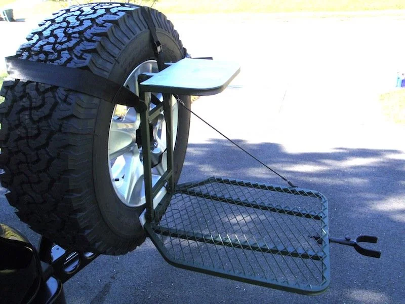

camp stove
who makes the camp stove platform that seems to connect via straps to the rear tire carrier? Do you like it?

str8nm,
The stove platform is nothing more then a modified deer stand. We used it during our Colorado trip multiple times with no problems.

str8nm,
This is what I did for the tire table (AKA a deer stand):
Only installed one support wire - this allows side access to the table.
Didn't installed the seat material that came with the stand, instead I installed a white piece of plastic to the seat as a smaller table for cooking items.
Zip tied a piece of foam as a buffer between the base of the stand and the tire.
Installed a Bow holder to hold the propane bottle when it is attached to the stove.
Use a second strap to secure the top of the stand to the tire.
I hope this helps, if you need anything else just let me know.

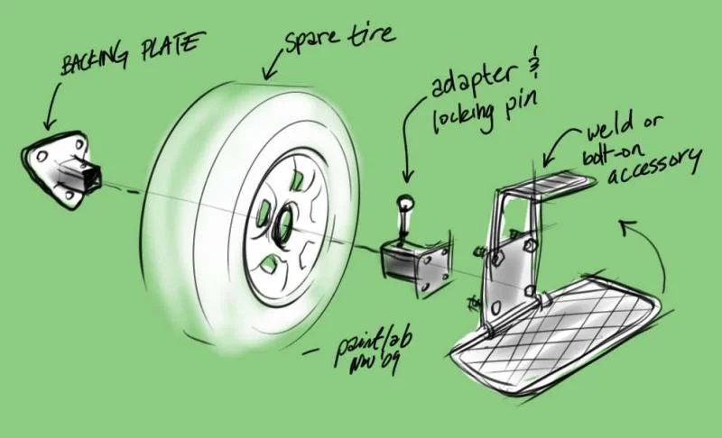

Yea I know, I am going to try and find a way to mount it into the receiver end of the tire carrier.

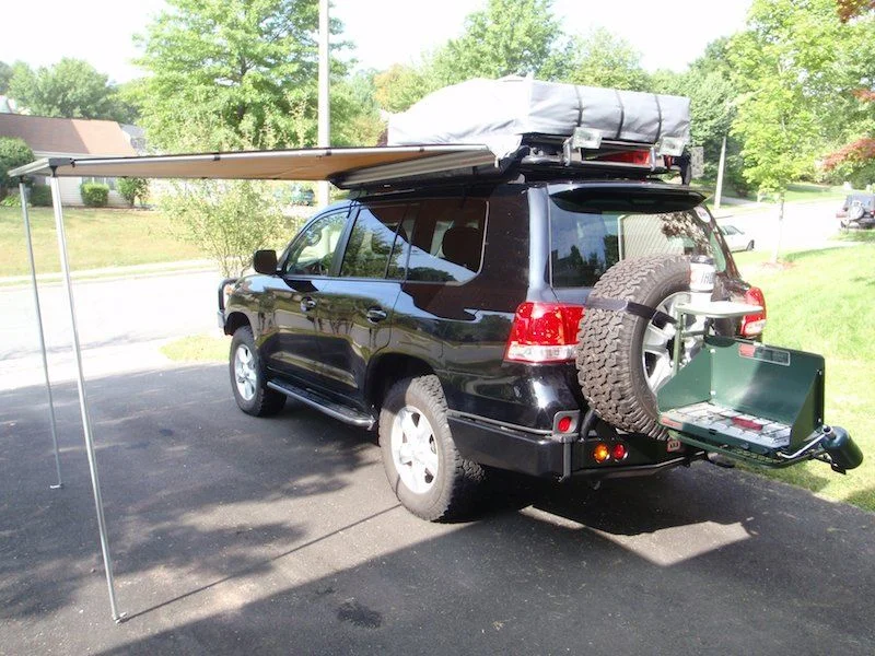

FirstToy,
I am now looking at how I can attach the table directly to the spare tire mount rather then the spare tire. If you have any ideas I am all ears.
Where can I find the gas can mounts?
sbly
Old 11-08-09, 03:28 PM   #120 (permalink)
tlcwagons.org
FirstToy's Avatar
Join Date: Nov 2003
Posts: 3,745
sbly,
this is what I did on mine, except I use a metal basket instead of your flip table.
I think I will add the table though, it's a neat idea.
the ATV gas/water tank mounts are kolpin (or several others have some). That's what all those pill-shaped slots are for in the tanks.
For example,
Kolpin ATV Pack Mount At Parker Yamaha Com
or maybe it can give you ideas for your own
