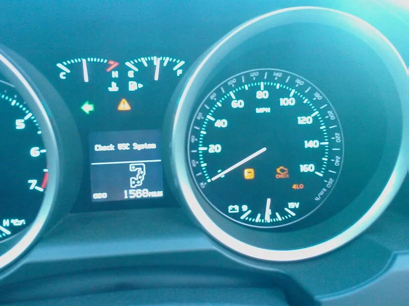

So today as I was driving (highway), my info screen said check VSC system, and 4-LOW light started flashing.
When I put my foot on the brake (no joke!) the gear position on the info screen disappeared (it shoes the shift pattern, but no dot or P, D, N etc.). The rear camera showed on the info screen and the mirrors dipped down like you were in reverse. I have a bike rack on the back and the park sensor started beeping.
I pulled over, turned off the car and turned it back on again, and I had a check engine light. What the hell!
I can repeat this EVERY time I put my brakes on, lol!

Here is a pic of the dash. Notice the gear indicator. It's not there! I'm in Drive, 4HI, making a left turn.

Wow...that is weird!

Can you do a 'hard-reset' of the computers in the 200-series? Check the manual. Switch everything off, lock and unlock a few times then restart and if you're lucky, everything should be back to normal.
If not, switch everything off then disconnect the battery. Wait 10s and reconnect. Try again - all warning lights may light up for a few seconds, but should go out.

Such a range of things that could cause this; from loose battery connection to failure of ECU.
The way you describe though it sounds like a short or bad ground.

I'm guessing it's a short somewhere. Something that activates with the brake pedal, such as tail lights, causing a false ground.

She just called me back from the dealership and:
1) They reset the LAN settings which now reports the "3D Hybrid" antenna status correctly
2) New drive shaft is installed
3) There was a DTC code which reported an unknown problem, but all the systems reset themselves I guess and it's back to normal. They just cleared the code and drove it around. Seems good now. Can't do much else till it happens again, but hopefully it never does.
I'm picking it up later and will report back

Got her back.
She's smooth, no error lights, and I'm not driving to Africa anymore
