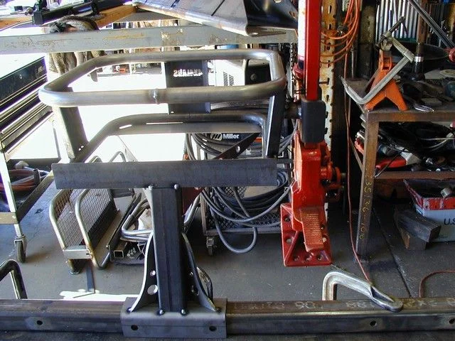

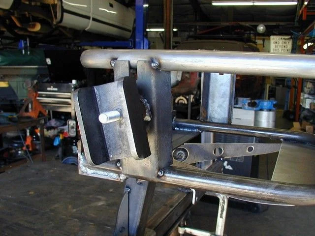

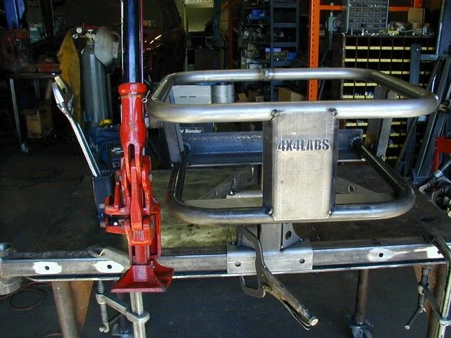

Bolt the Hi-Lift bracket to the Jack just above the lifting part of the jack when the jack is in the fully lowered position. See Pic 31, 31.1, 31.2
Place the jack next to the side tube spreader and tack the standoff in position. This step will take two people. Stand back and look at the angle of the jack to make sure it is where you want it. The point of the lifting part of the jack will nest nicely into the detent of the back hatch where the license plate goes if positioned properly.
