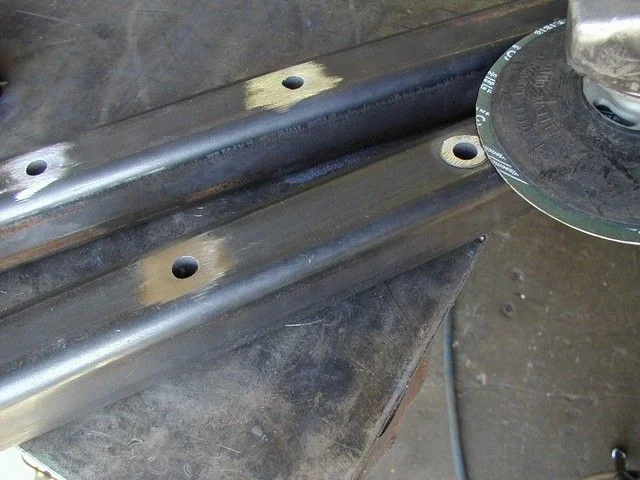

Swing arm sleeves
Swing arm sleeves are usually pre-drilled in the correct location. If you have a single swing arm you may have to drill your own holes for the sleeves depending on the desired location of your accessory carriers. Slide the sleeves into the holes. Tap them in with a hammer if necessary. Weld around the sleeves and grind smooth. See Pic 17
