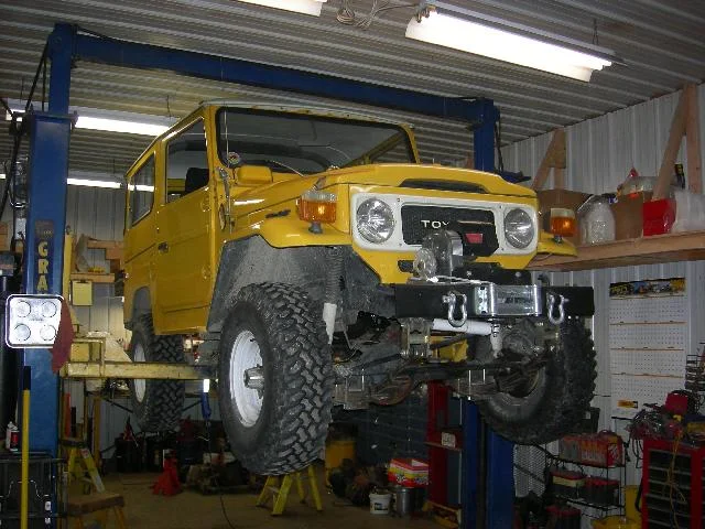

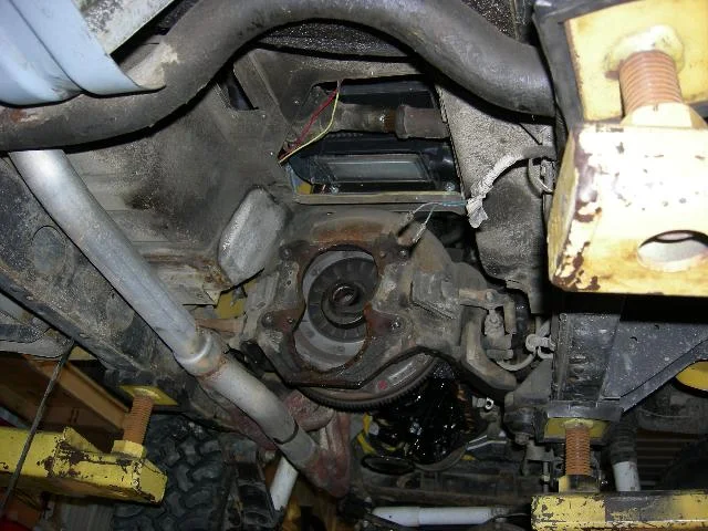

Pulled the H42/onepiece case from this on Saturday. The oil pan gasket/pan was leaking so that was dropped as well and will make it really easy to swap out the rear main seal, when the clutch and flywheel assembly are removed.
