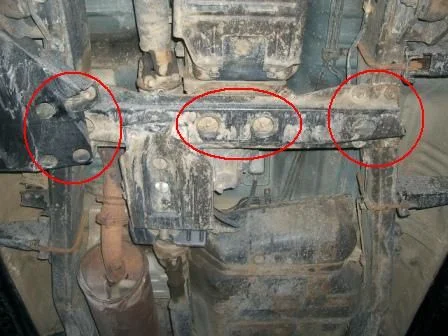

Step two
BE CAREFUL!!!
Unbolt the two transmission mount nuts (17mm deep socket).
Loosen cross member bolts (14mm socket) 4 each side, 8 total.
Do not remove cross member bolts at this time!
Step three if you have sliders, otherwise skip and move on to step four.
BE CAREFUL!!!
This step is for my particular sliders equipped with a catalytic converter skid plate, but I would imagine others would use a similar procedure, if at all.
Passenger side (US model) loosen rear U-bolt (3/4” wrench, 3/4" socket).
Passenger side (US model) remove front U-bolt (3/4” wrench, 3/4" socket).
Step four
BE CAREFUL!!!
With transmission properly supported remove cross member bolts.
Warning, the transmission will no longer be completely secure during and after this step!
