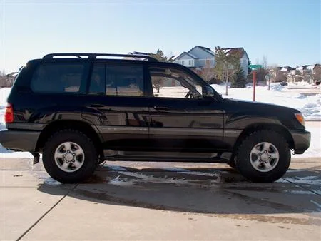

Tires installed. Created a lift
Measurements: Front from ground to fender - center tire cap: Before 33.5", after 35" - 1.5" lift (aprox)
Rear: Before 35", after: 36". Changed from a 1.5" rake to a 1" rake?
Results: I love um - they already lifted my new ride and they fill in the wheel wells very nice. If nothing else, IMO they make my 100 stand out from the mall cruisers just for the looks alone. Another pulled up next to me in a pearl white - mine does not look so much like a anymore
Now, the tune-up items.
