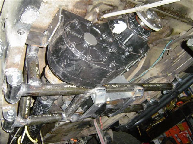

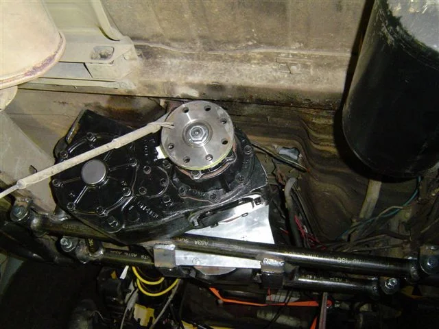

Well its been ahwhile since my last update. I have the whole doubler rebuilt & together, clocked & installed in the truck. Last night I finished the cross member. This is one HEAVY, long combo (probably 250lbs+).

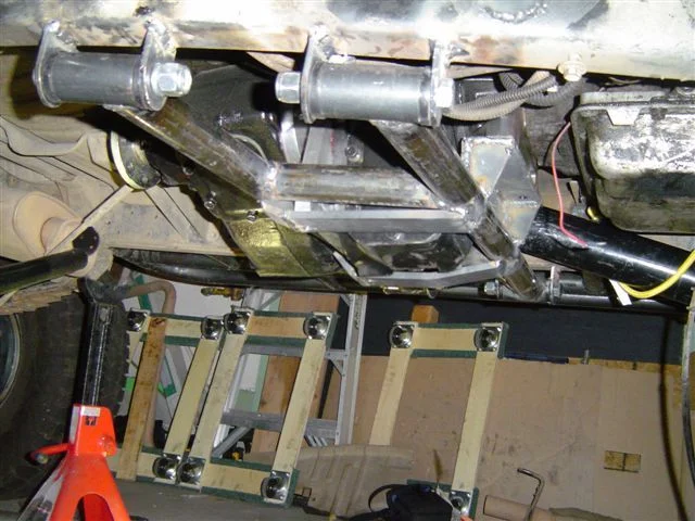

The crossmember is built using 1-1/4" schedule 40 pipe using fj60 spring bushings at the frame. It mounts to 3 points; the trans adapter, the doubler adapter & the side of the 205. hopefully its strong enough to hold the combo firmly without bending. I need to replace the rubber bushings in the motor mounts with Poly to hopefully sychronize the engine/ trans combo movement.
Anyone know where to get Poly bushing to fit the crappy AA motor mounts?
The 205 is tucked to within 1/4" of the body (after clearancing of about 1" couretesy of my BFH) & the 203 hangs below the frame by 4". I would have had to cut the body to get it any higher.
The front driveshaft is going to be a HAD 1-ton CV @ 42" long & the rear is the same but only 29" due to the long pinion on the Sterling & the long drive train. one thing I found out, is that the Sterling is passenger offset by about 1.5" (roughly 3 degrees) so hopefully it will not give me a vibration.
Now I need to pull everything out & clean things up. Then I need to fab tripple shifters since the trans is costing 2x what I had anticipated ($1150, so prefabbed cable shifters will be out of the question).
I'll also be pulling the Sterling to clean it up & install the detroit.
