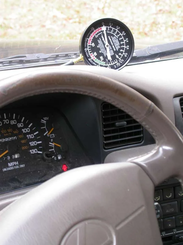

Driving Test
I removed the clutch master plug in the firewall and ran a vacuum line from the engine bay into the cab and hooked it to the vacuum gauge.
Use it one of two ways,
One way to hook it up reads the pressure to the EGR valve with everything intact.
Make a 5” or so vacuum line with a ‘T’ in the middle one end goes on the EGR valve, the other on the nipple on the intake manifold and T in the sense line to the cab, (see pic 1)
When you first start up cold the VSV is open so you will see no vacuum, shortly after the vacuum should start to follow throttle plate position
Idle, no vacuum,
Cruise, lowest pressure, on a slight downhill as low as 12 or 13 inches of mercury on steep down hills the pressure would increase, and uphill it would also increase
Regular acceleration ~5 inches of mercury
Moderate throttle to WOT, no vacuum
If you are not getting any vacuum the Modulator is either not providing any or more likely the VSV is open defeating what is being provided.

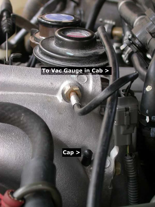

To test with is witch the other way is to watch just the modulator alone: remove the short line that runs from the nipple on the intake manifold and goes to the EGR valve, plug the intake nipple and hook the sense line from the cab to the EGR valve, (see pic 2)
Now you can drive around and see the signal that the modulator is sending to the EGR valve without interference from the VSV,
If it works as it is suppose to this way but did not before then most likely your VSV is bad, if you still have no vacuum the modulator is bad or there is a plugged line or a vacuum leak somewhere.
Be aware that because the VSV is out of the picture and unable to kill the EGR during warm up that it will throw a P0402.
