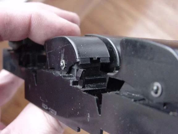

I received the dead switch assembly from RavenTai today. As promissed I dug in and modified the assembly for auto up ability. The Mod consists of 2 changes to the switch assembly for this function. I'll have to post another one for the second change and it's pic.
1. You'll need to give the switch itself the range of motion so it can get that second click as it does in the down position. This is done by trimming the 2 tabs along the back side of the switch. I wasn't too careful here just took off about half the tab. To get the switch off you'll need to remove an E-clip and slid out the pivot pit. The switch then lifts off and you can easily trim it. The pic here shows the 2 tabs already trimmed.
