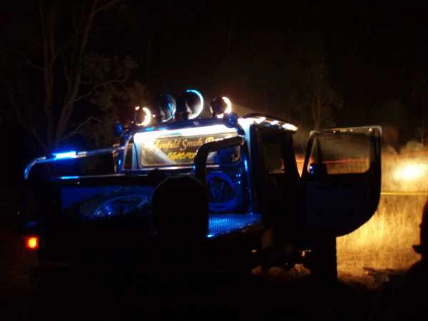

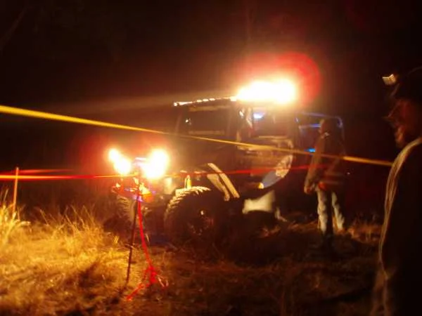

For those of you who don't know what a F55 looks like (nothing like a FJ55 for starters) here's a couple of pics of "Piglets" rig which will be very similar to my proposed build.
