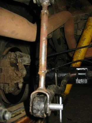

Here is the extended sway bar. I cut the stock one, sliped it into a piece of 1/2" tubing with a piece of round stock in the middle. Tack weld the tubeing to hold it together. You have to take a tiny bit of material off of the sway bar round stock to get it to slide inside the piece of 1/2" tubing.
