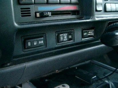

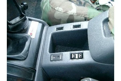

The remote controls mimic my set-up from a few years ago. I too selected the antenna switch as it eliminates the requirement for additional relays. In addition, I mounted the cable control switch in the center console with the cable-in and cable-out positions intutitive in relation to the vehicle position.
I also incorporated an arming swith on the istrument panel.
