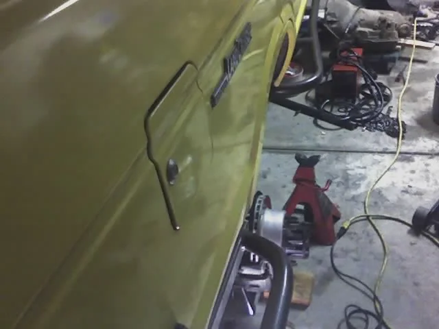

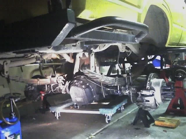

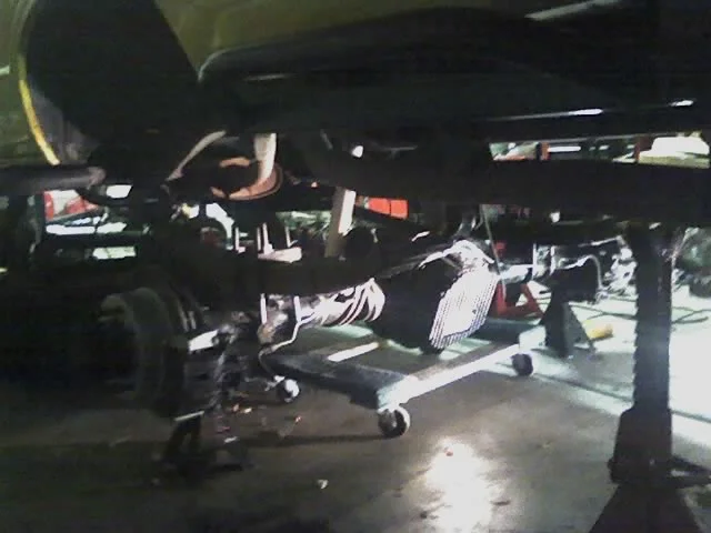

I bolted up the sterling last night... can you say BEEFY?:
