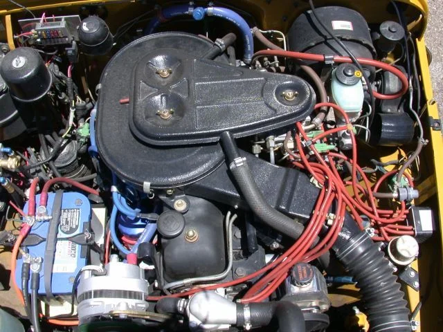

The photo of the engine compartment does not jive with my Fed spec 78. The line to your brake booster comes from the intake manifold and the port on your air cleaner goes to the valve cover.
