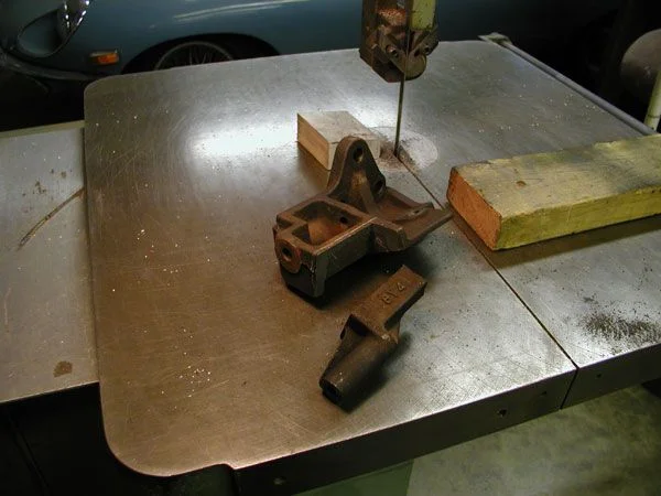

Alternator bracket from a 62
OEM;
Alternator
Fusible Link
Wiring Harness (part of it anyway)
Ignition Relay
Water Pump Belt
Non OEM;
106mm Pulley
8mm spacer for tensioner bolt
On an FJ62 the alternator goes where the FJ60 smog pump sits. The 62 bracket bolts directly to the 60 block and body mount.
The bracket needs to be cut a little to give the alternator enough room to swing.
