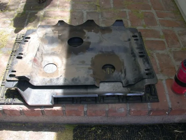

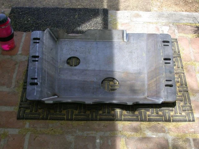

I just wanted to share some photos of the FJ40 skid plate I just had fabricated here in Tucson. Except for one small triangular gusset it is made from one piece of 3/8" steel plate using a CNC precision plasma cutter. All the slots, holes and outer edges are smooth to the touch and need no secondary finish work. As you can see from the photo, I extended the skid plate back to fully protect the emergency brake.
