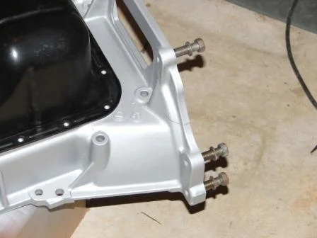

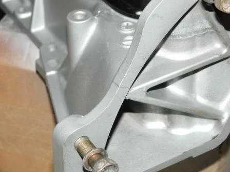

Tonight I was taking it easy and cleaning up some parts and saw a crack. I didn't notice it during the hours I spent cleaning the pan , but when I put a thin coat of "Alumablast" on it it jumped out at me to make my bad day complete. Question is, is it a problem? Seems to me that Toyota intended for this oil pan to be a structural part of the engine as they put 6 big freaking bolts from the transmission into it. The crack isn't in a spot where I will loose oil out of the crankcase though. Had I not painted it, I don't think I would have ever known it was there.
So far, I've dropped close to $2K in parts in this repair and i'ts not back together yet. Its amazing what you find to replace "While you are in there". When I get all done, I may try to write it all up - it has been an adventure so far. My wife wants her truck back yesterday, and I'm still finding stuff wrong.
So what do you guys think about this pan crack? Replace it? (I hate to think what that would cost) Try to weld it? Let it ride as is?
