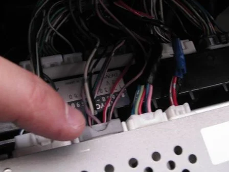

Took this project today in my 2002 LC. Worked beautifully - I followed the instructions found here:
http://us.lexusownersclub.com/forums...dpost&p=101454
This link should be the post entered by "laxman310", which describes the process very well without purchasing any additional equipment. It's just a matter of clipping a couple wires and grounding an end (once you get the nav system out).
The reason I'm posting is that the wire harness described was a different one on my 2002 (I believe his was a 2004). The wire colors were perfect, just a different set of wires. I've attached a pic, pointing to the right one for me. Took a leap of faith, and it worked like a champ - 15 minutes.

I did this mod awhile back on my 04LX which has bluetooth. Doing this mod will allow you to enter a phone # while in motion. This will not allow you to enter a destination while in motion. You can access a hidden (Service) menu that will allow to enter a destination while in motion, but it resets back once to shut down the engine/power.

just did this mod, worked perfectly. had a user error which required splicing a wrong cut, guess i'll find out sooner or later if my splice was good
