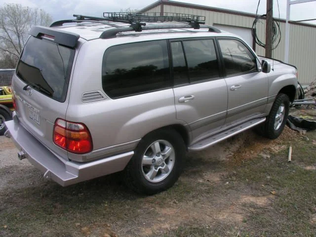

Wngrog, in your picture are you deciding on what roof rack to use? (I noticed the one in the background).

No that is the aluminum receiver rack. I have tons invested in Yakima stuff. I will be using Yakima, I don't want to start over now.

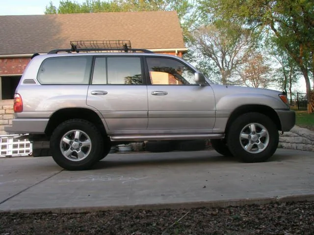

Damn you like to draw on your driveway alot! Every pic I look at has hieroglyphics in it.
Rig is coming along nicely; I can't wait to see all of the color keyed armor in place.

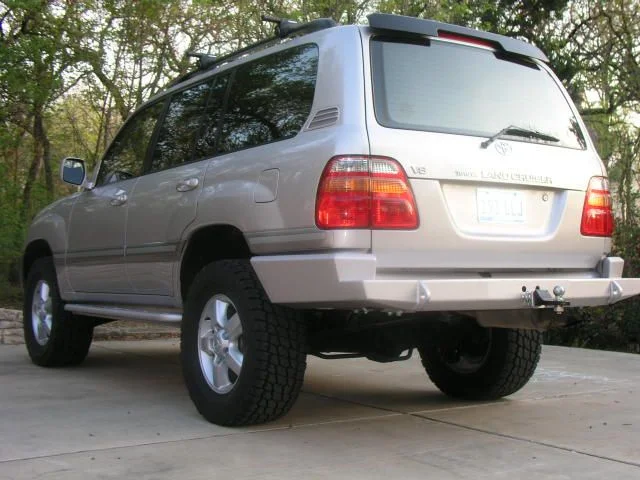

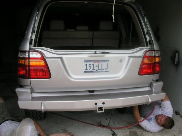

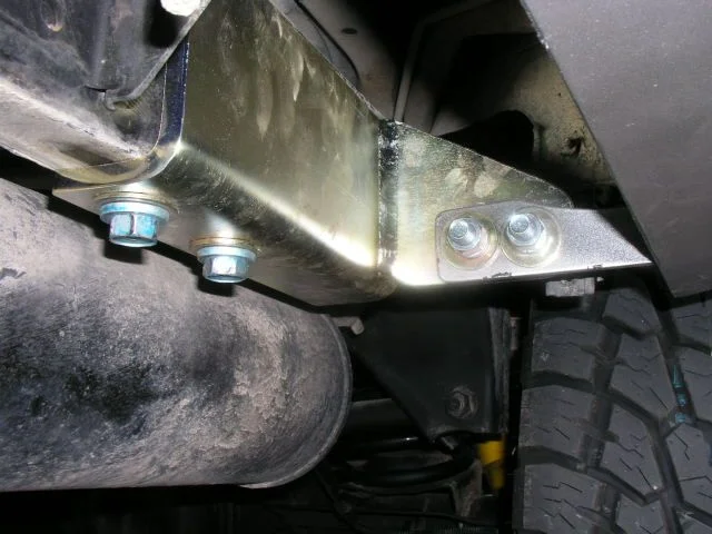

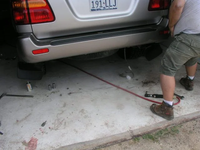

Did the install of the sliders and bumper. My buddies chipped in and with their help and me stopping to take pictures the old stuff was removed and the new installed in 40 minutes.

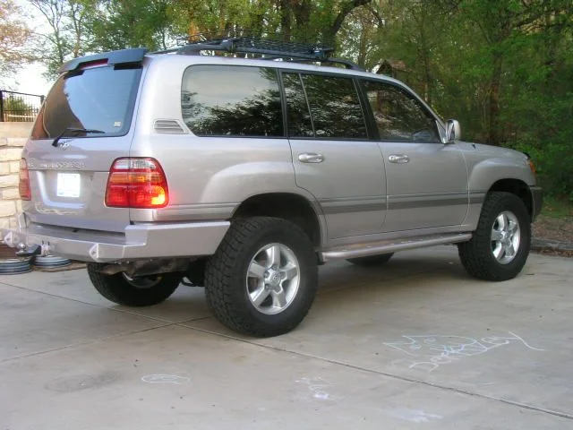

I really like the bumpers being painted the lighter silver like the body instead of the darker color the old bumpers were painted. Thanks Garth for the nudge in that direction.

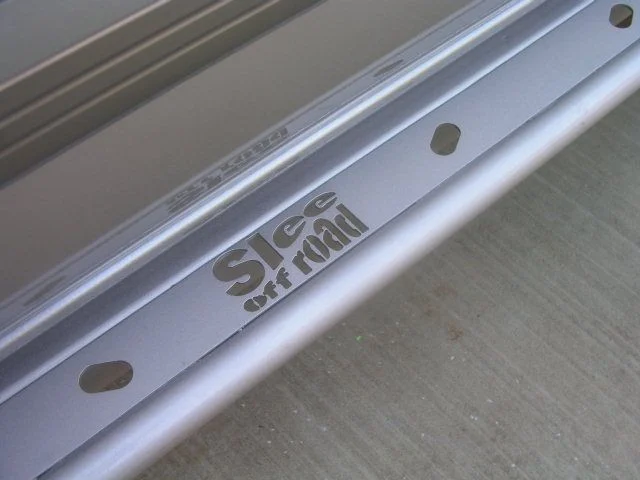

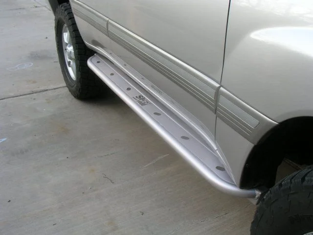

I can not say enough about the quality of the Slee Sliders and the rear bumper. All the holed line up perfectly, the instructions are clear, the packaging is perfect........

Looks GREAT!!!! Love the match. Very low key, very stout.
What are the plans for the front end?

Quote:
Originally Posted by ats4x4dotcom
copyied from bulls build post-
"You should maintain a minimum of 70mm [2.75"] of droop in the 100 IFS front set up, if you have a Slee diff drop fitted, to stop the cv boots wearing out. [boot pleats shouldnt be touching in straight ahead position at ride height]
This is normally 50-60mm higher than standard, depending on accessory levels.
on a 16" rim this makes for 770mm [30.3"] measurenent from bottom of rim bead edge up through centre of wheel to fender edge when set up correctly.
Rear should be aprox 790-800mm [31.5"]"
OK, after installing the Slee bumper it did not come down at all......with or without the spare in there.
Front (with 18" wheels) is 31.5" and the rear is 33"
1.5" rake back to front.

Quote:
Originally Posted by wngrog
Christo and Darren, if you are reading this, I would like a set of those Bilsteins for the front so I can crank the bars up another 1" to level it out.
You are within 1/2" of where you would be with the Bilseins at the moment in the front.
Your 100 is really coming along nicely! I really like the paint scheme you went with too. I paint matched my front ARB and Slee step sliders, but I went with the gray like the original bumpers. I haven't painted my Slee rear yet because its been too cold.
Now that I've seen yours and Shotts, I'm really considering pulling the front bumper and sliders and painting them green at the same time that I paint the rear bumper. I've been considering having the body trim painted anyways as its peeling in a couple small spots. I'm just not sure how the dark green would look for the whole rig.
I look forward to checking out your 100 at Moab!
I like the way the 100 IFS sliders Christo have done are just the right height to stop the wayward shopping trolleys from putting dents in the doors while wheeling the local mall for a lo cal, lo fat, decaf, half strength, soy latte

Greg, I plan on painting the front bumper with it ON the vehicle. Besides the sliders, the F and R bumpers would be just as easy that way.
Ha Ha! I know you're just yankin' my chain a bit, but I will say this. Last week-end I went wheelin' and on this particular trail there is a section with a 4 foot tall wall of dirt and tree roots on the left side and the trail slopes hard left so if you go wide you'll slide into the wall.
So, you have to put your tires up against the wall and try not to slip into the wall. Slee's step sliders are perfect for this. Once my front tire was against the wall, the step slider stuck out just enough to keep my doors out of the wall.
Some other type of slider that didn't stick out as far would not have given me this protection. It was pretty cool to slide the length of the slider on a tree root and come away unscathed. Thanks again Christo!
Sorry for the hi-jack wngrog.
