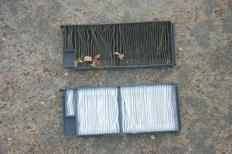

I just replaced the filters on my LX. I got the part from Lexus and it has Toyota numbers; made by Denso. The instructions on this thread made the job a breeze. Thanks.
