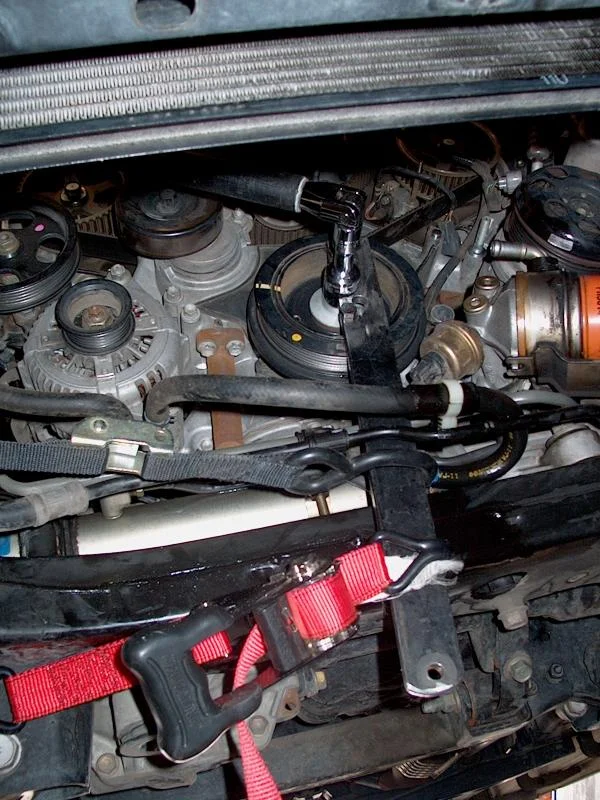

Homegrown SST Tool in action
The crank tool is a must, imho.
Pic #1, notice the 48" Yakima cross bar on a breaker bar, although I enjoyed reading the Fence post method agomez. I was solo, hence the double tie down straps holding the bar opposite of me loosening the 181 ft pounds.

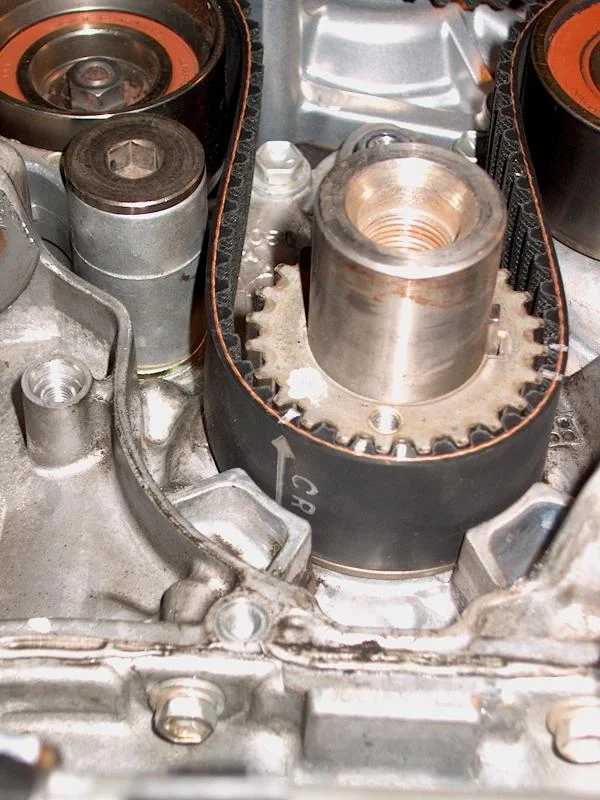

Pic #2, my favorite photo of a new belt lined up on the crank.
