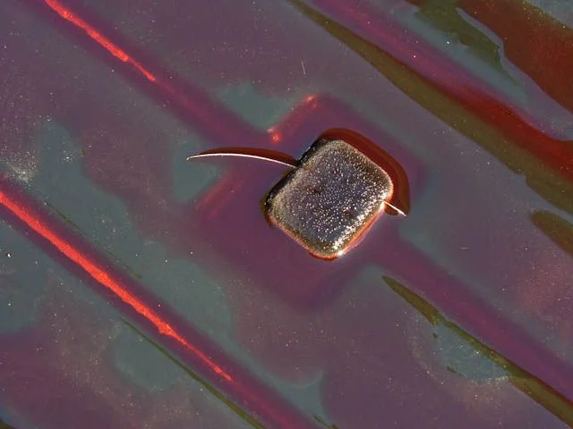

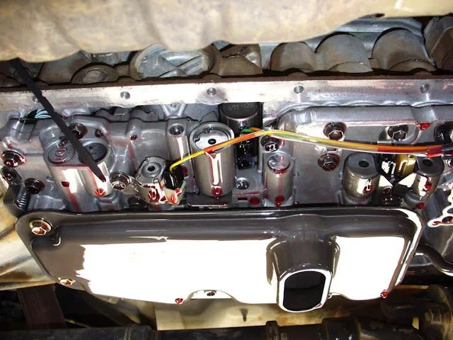

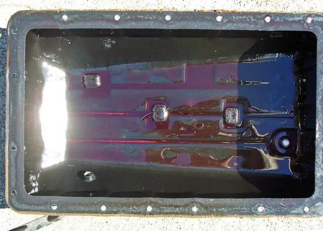

Have few photo of pan and bottom of transmission. I am assuming this is a normal amount of metal shavings. The one wire like piece makes me wonder. Need to now match up what is wrong with a part number. Seem FSM and Parts diagrams have different names. I seem to only have 3 magnets and a gasket rather than FIPG material.
Let me know if there something I need to be concerned about.
Skidoo

great photos. The wire looks like a cut-off piece of 'safety wire' way too big to be a 'wear product'. The collection of fine wear metal looks normal--no large chunks or lots of debris--cleanliness is EXCELLENT. Good job on keeping fluid changed before it starts leaving varnish.
Should be straightforward. MUST have 'exploded' diagram of valve body and detailed description is dis-assembly and reassembly instructions B4 you take it apart.
