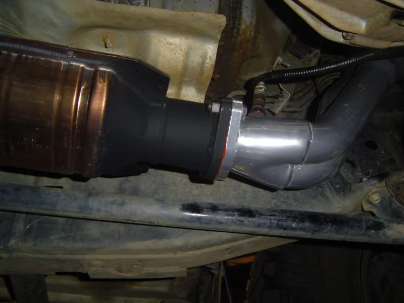

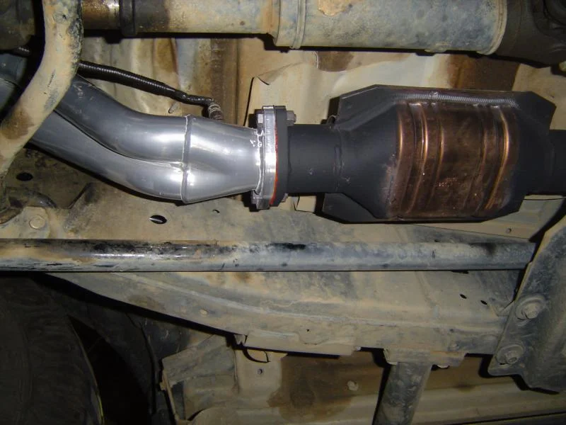

new exhaust pics

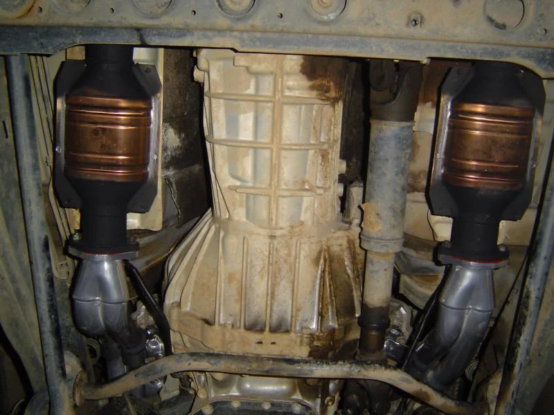

as promised, here they are
just before they go into the 3" collector
extractors and high flow cats

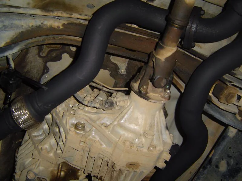

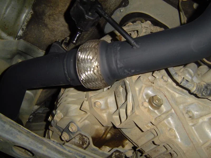

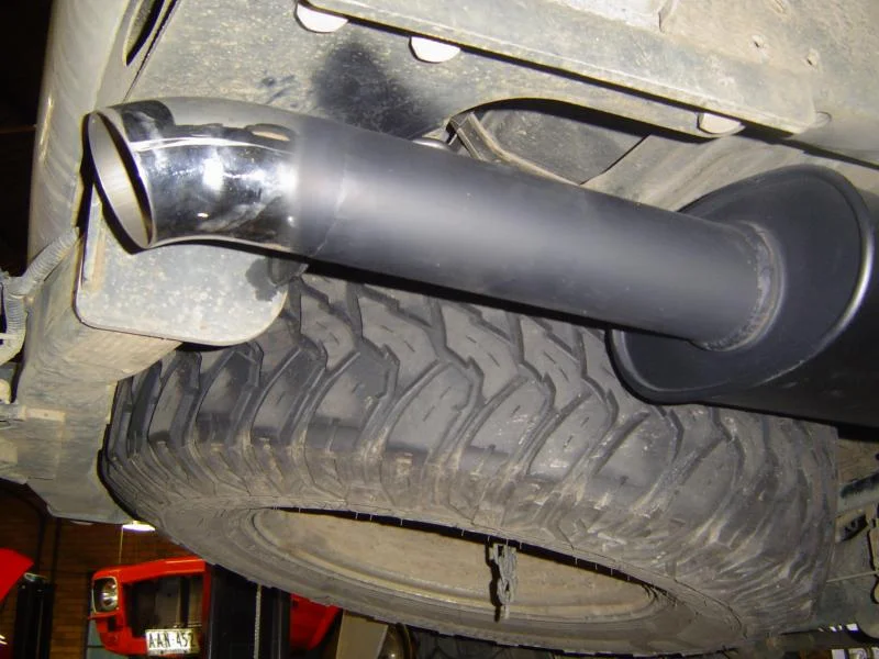

a few more
left side
right side

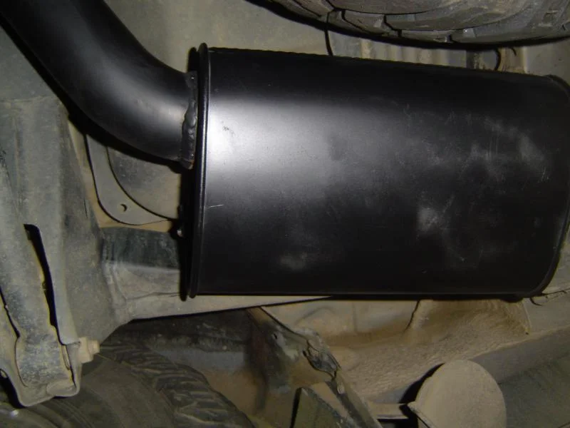

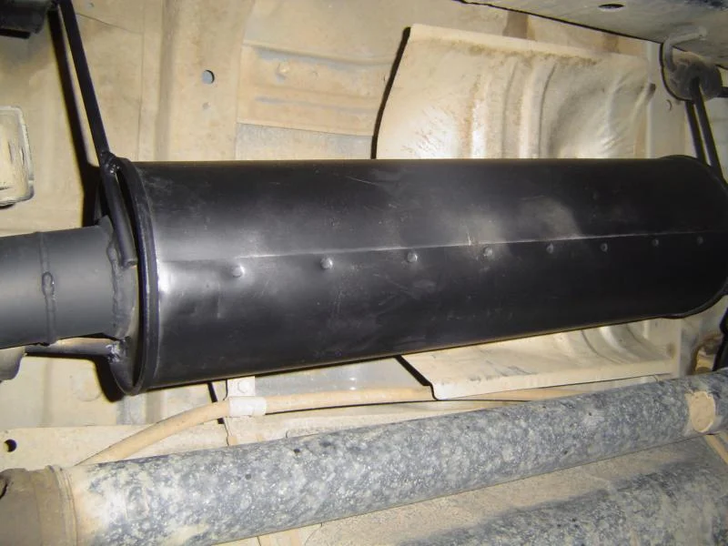

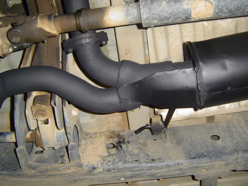

and a few more

Looks great! It would be interesting to know what if any HP was picked up with your new exhaust system. How big of a job was installing just the headers? Plenty of clearance for them?

mr spressomon! good to hear from you!
i dropped the beast off on Wednesday morning and picked it up Thursday afternoon. They forgot to do the photos so i asked them to do it today...well yesterday now, but Friday. My insurance co will need pics anyway.
The Pacemakers have an install guide downloadable from their website which says it's about a 4 hour install but i think that's if you've done it before.
More like 6 - 8 hours for the home mechanic that kinda knows his/her landcruiser 4.7L V8.
Mine was custom in that i am planning for a future install of a Harrop supercharger so i wanted a 3 inch single system instead of a 2 or 2.5 inch.
My Scanguage II hasn't shown any economy gains.....mainly, as i PM'd you and hoser, it sounds so damn good you just want to leave it in a lower gear.
i did take out onto the Princes Highway/freeway for an hour at our two limits of 100km/h and 110km/h and the Scanguage showed pretty much what i was getting (fuel economy) when i changed to the K&N air filter....but bear in mind...i was playing around with cruise control and testing out the acceleration of the beast too.
I now have a first gear i am happy to use on the road instead of getting into second gear asap as i mentioned in the PM.
The acceleration is there - typically before the exhaust install i'd go to 3000 RPM and change gears from 1st through 4th (it's a manual remember)....but i have the novelty factor now where i'm going to 4000 RPM sometimes just to see what it can do. Bearing in mind i now have 112k kms on the clock....it still sounds amazing. And the deceleration sound is like whoah!....
The sooner i get a video uploaded somewhere the better so you guys and gals can hear it. My one concern is that it might be a little too loud as it IS turning heads if i sink the right boot into it! But i am used to that having owned an Aussie muscle car, a Monaro, for 13 years with an exhaust from the same company - Performance Exhaust.
I'll just have to take off slowly from home so as not to piss off my neighbours now!
Weird how i couldn't even hear that it was a V8 even in car parks with all my windows down before i got this install! I think our stock exhaust here is way different to the USA spec.
I'll let you know when i have a video link to share
cheers
peter

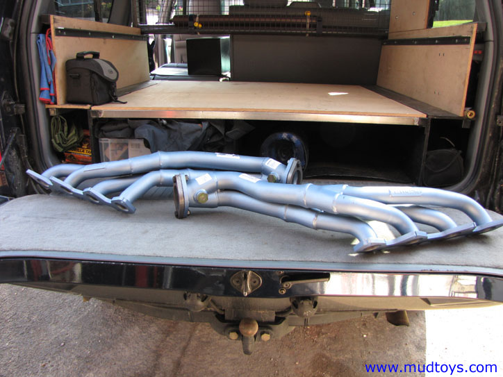

Apparently i can get the 4.7L 'cruiser engine bay looking a little like this.....(possible subscription required...not sure...over at lextreme.com) 4L Lexus V8 in a HiLux...obviously i dont have the SuperCharger installed....yet...it's coming....
but given the new exhaust and the power i have now? Suspension fix up is what i need first!!
thread is here ...scroll down a bit for this pic and others.
comments welcomed if you know.

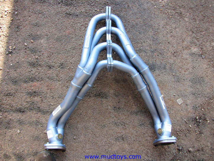

I'm pretty sure the headers I have are the same (but uncoated) and still not fitted so I have some pics that might help watchers:

jon
i was hoping they would lie down the exhausts for the before and after but the installer guy "forgot"...despite it saying TAKE PHOTOS on the build sheet.
that's ok.i took it back, they took off my skid plates and took the photos i have posted.
i got mine ceramic coated coz of the research i did about superchargers and heat even tho i probably can't afford the supercharger for another year or two!! hehe.
i was surprised how small the Pacemakers were tho. 100TD mentioned the Genies were bigger in terms of specs....and my original choice of a custom system from Bullet Cars in Queensland (Oz State) were "custom made by Genie" too.
However, my decision was based on what i posted earlier....getting info and experience with the installer.
i also had another company spruking their wares (selling their product) and it looked good....
custom made extractors, high flow cats, etc...and a UNI-Chip add on.
Two issues with them.
1. UNI Chip....you need to go to an authorised UNI chip dealer to have it tuned. Well...when i'm in the Simpson Desert 1200KMs away from anywhere with my laptop and an OBDII reader/scanner/programmer? Nope cant be done. Easily at least.
2. Also, this company was recommending a "fuel atomiser/atomizer" from Europe that would improve my fuel economy. They cut open your fuel tank and insert some weirdass device that atomises my petrol/gasolene thus giving me better fuel economy.
Cut open my fuel tank. Insert something in there...atomises my fuel......Yeah.
Hang on, it's Elvis on the ....oh nevermind...
Right....Credability...gone right there. PM me if you want to know who they are!!
Get an Xede, or other 3rd party piggy back ECU....then you have a chance of anyone in the outback or whereever in at least tuning the car so you can get it home or a major city instead of a proprietary aftermarket thing like the UNI Chip where you HAVE to be an authorised dealer to use it.
anyway, those extractors/headers look the same as mine
the comments i got from Performance Exhaust were from the "Landcruiser guy" around that i ordered a 3 inch single vs 2.5 inch.
"i wish i had got that now". or words similar.
cheers

Jon i think those extractors/headers are the ones!!
mate i have to either buy a new digital cam or talk to some friends that i need to say "hello" to.
hehe
the reason i posted the HiLux pics....was
1) the valve / rocker covers will fit the 4.7 (supposedly....not verified..)
2) And the man knows His HiLux,
be sure to keep an eye on my LC.
it's all good!
