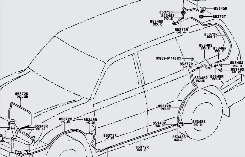

Without going to look. Rear window washer line...since there not a fluid reservoir in the back.

Posts: 4,594
Quote:
Negatory Ghost Rider . . .

I don't understand why Toyota just didn't put a reservoir and pump in the back, like they did with the 60-series. Having tubing taking a torturous path from front to rear with what looks to be 14 different fittings just seems like a leaky nightmare waiting to happen

Two different reservoirs to fill? Plus you have to fill the rear tank from the inside of the vehicle? At least that is how I have to do it on my 70. I prefer the 100 design... fill the reservoir when you are checking all the other fluids. And since I have not heard of anybody having problems, it must be somewhat reliable.
