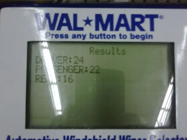

i knew taking a pic of this would be worth it. Here ya go bud. 100 series wiper specs.

What blows my mind is that anthonycds anticipated this question and spec-built a multimedia answer !

just google or call the damn dealerships. finding a wiper size isnt a hard task... which reminds me. i gotta get a new rear wiper. Finding the right size evidently is, I was first told by a local O Rileys parts store they were 18 both sides they even looked them up on their computer, then some references have them listed as 24 and 22 inch, come to find out the correct size is 20 on both sides and 16 in the rear on the 98 and 99 models. Wipers may not seem to be very inportant to some but they are to me and I want the correct size, im that way, just like I will only use OEM or Wix filters and michelin tires and only drive Toyotas.

FYI - you may find that 16 doesn't work. I put both an OEM and aftermarket 16 on my 99 and the last ~1" of the blade hits the molding at the top of the window. I decreased the wiper size to 15 and it works fine now. I haven't figured out why this is the case yet.
