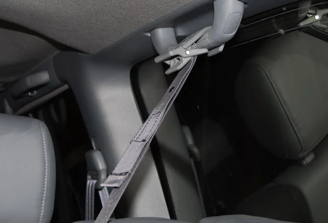

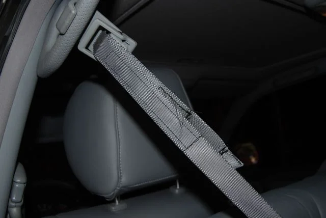

Hello everyone,
I have been lurking around trying to find the answer to this question...tried searching and the FAQ, but wasn't even sure what to call the things.
What are the straps that secure the back row and third row seats when they are folded up called?
Can these be replaced? The velcro has ripped out of all of them.
Thanks

i'd re-stitch some new velcro on there. easy fix.pick up some at home depot or lowes.
the straps are called............straps. or seat holders. i dont think there is a technical name for them.

You can buy a replacement, but it's the whole thing - strap and hook. Looks like they're about $50. The EPC name is "band assembly, fold seat stopper".

can also check toyodiy for oem parts and find the part# 78950-60070-B0 which i did for ya, and give Dan the Man a call to place an order.
Part# is for the gray one which it looks like you have.

I purchased industrial strength peel and stick velcro from the local auto parts store and it works like a champ. I am going to stitch once the adheshive lets go. That has not happened in over 6 months. The auto parts guy told me that the velcro was used by the city on outdoor applications and lasts along time. It cost 6 bucks. I took off the original pieces and stuck on the new pieces. I used longer pieces to allow for more surface area for a more secure connection.

I had new velcro sewn on at an upholstery shop. Pulled the seat out and dropped it off. Cost about $10.

Replace the velcro with a nylon cam buckle. Holds fast, tighter than velcro, will last the life of the strap, cost about a buck or two at any outdoor gear supply store. A nylon ladder lock will also work but takes a few extra seconds to tighten up. They are even easier to find and cheaper (not that $1.00 is going to break the bank).

Not on mine, the velcro absolutely holds the strap from sliding back through the hanger. The angle of the hanger doesn't provide any resistance like a normal nylon strap buckle would, it just loops the strap around. The seat will hold itself upright without the hanger, it just wobbles slightly.
I poked around tonight and can not see any way to easily get the plastic backing off the seat. But, the strap is long enough that I should be able to set the sewing machine right next to the seat and sew in new velcro.

Cory, are your straps threaded through the hook like in the pictures from the OP (mlchang)? Something's not right if you can't tighten the strap down.

Yep, just like those. There's no tension on the buckle with the strap looped through that way. It's just like a pulley. I couldn't have done it differently anyway, there's a button that prevents the strap from backing through. I wonder if the clip portion of the hanger is supposed to provide tension somehow, maybe the spring on mine is shot.
Oh, and I won't be sewing in the back of the truck, the seats do come out.

I pulled the 3rd row seats and put it next to the sewing machine and put new velcro on. Worked for me.

Sewed in new Velcro tonight - golden! No more wobble.
